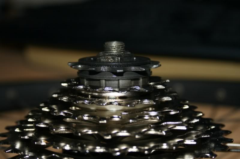

I may have made a schoolboy error, just tried fitting a 7 speed cassette to a new rear wheel and have been left with a gap, am i going to have to get a 9 speed cassette for this wheel, or am i doing it wrong?
you've got yourself a 8/9 spd freehub with a 7spd cassette
spacers man, spacers!

Yeah thats right, they arrived today by the way, Thanks! :) Having a bit of a nightmare trying to find an 8 or 9 speed Wavey :(
hamster":bbgjtmv5 said:
You'll find them in CRC etc.
Alternatively a spacer out of an old 8 speed cassette does the job perfectly.
I have an 8 (or maybe 9) speed wheel in the shed, will take the casstte off tomorrow and see if theres anything in there i can use, if not i'll be off round the local bike shops :)
