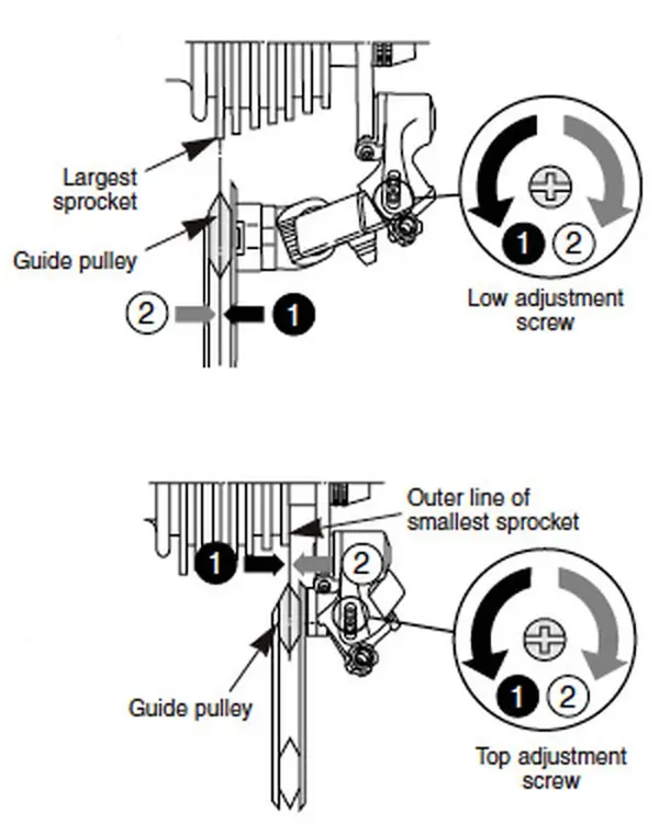

Looks like ten speed and as long as you set the stops on the rear mech up first and use a 10 speed chain, shifting is very very easy to set.

Stops are set, I think I now need to play with the cable tension for fine tuning, but I want to wait for the new chain to do that because this one is so badly worn out that I can't exclude that part of the laziness in shifting is due to the chain itself.
Btw, when you say "as long as you set the stops on the rear mech up first" do you mean that I first need to set the top adjustment screw first (smallest cog)?
set everything up first so the chain doesnt clatter into the spokes on the first test shift or jam itself between the wheel and stays
