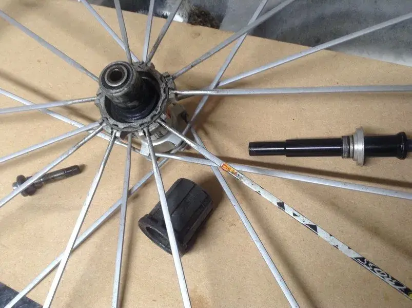

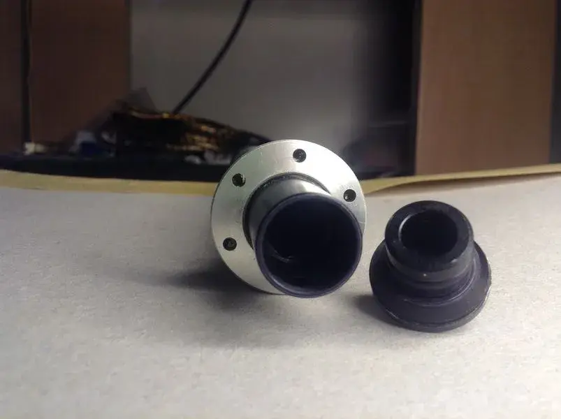

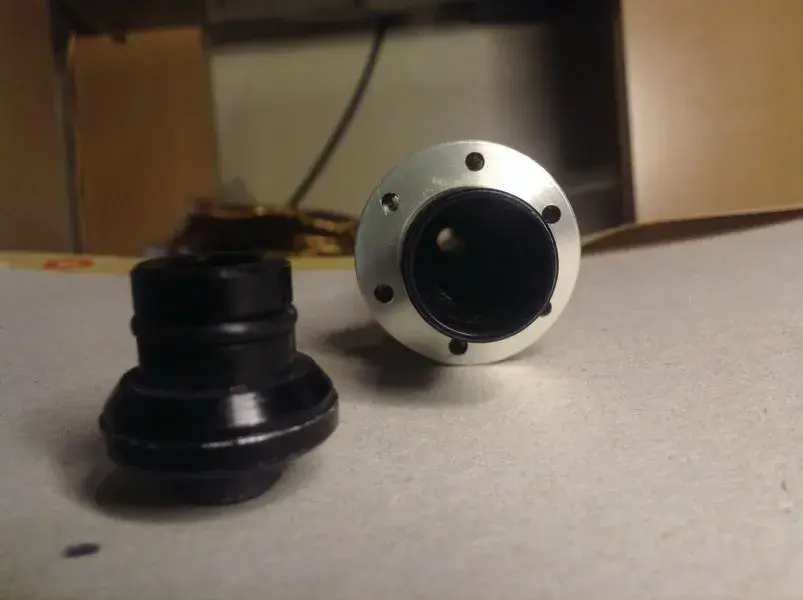

If it's the same as mine then just grab each end of the axle and undo with your hands.
will add a few pics of mine in a sec as I have just done this to demonstrate
excuse the dirt and grease on the wheel lol.
Hope this helps.
If it wont undo just with your fingers then you'll have to increase your power with whatever you have like a vice with soft jaws or axle vice or whatever.
wear a pair of washing up gloves might be enough to give your fingers a better grip.
Cheers
DannyB

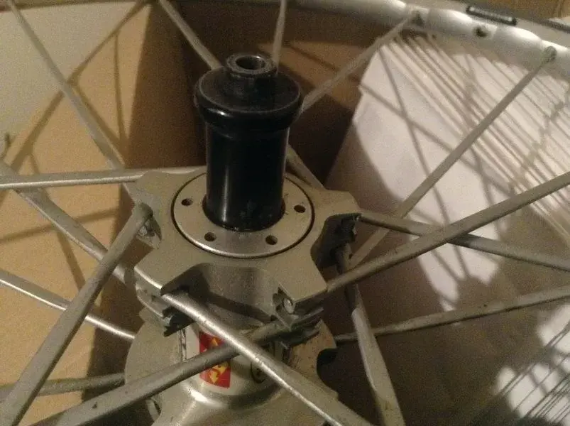

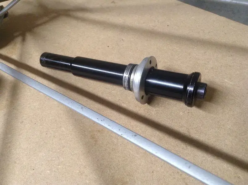

Sorry forgot how it worked so have edited this.
Just pull the end of the axle firmly on the non drive side and it comes off to show the allen nut behind it

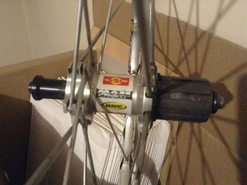

Yeah, that's what you need to service newer Mavic hubs, where you could put the 10mm allen key inside of the axle on the non-drive side. My axle is completely round inside, which means you can't use the 10mm allen key to hold it still.
