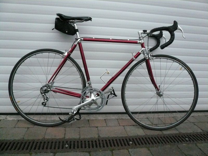

Finally finished the Alan
47p2
Well until the next item crops up

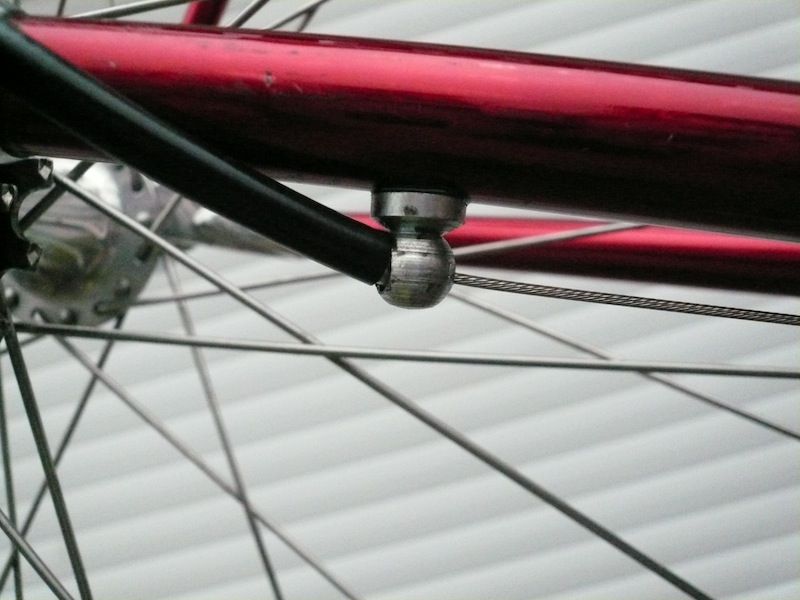

The rear derailleur cable stop was missing when I bought the frame and from the numerous Alan frames I've looked at, the majority have a non original item, some looking better than others. A lot of research and several months later I could not find the correct item so I decided to bite the bullet, take a chance and source one from a Vitus 979 which was being broken in Canada. When the stop arrived it was apparent it wasn't going to be as simple as first thought. The threads on the Alan are tiny, about half the size of the Vitus threads so I had to find an engineer who was competent enough to turn the stop down and re-thread it.
So now I too have a non original cable stop, but I think at least it looks better than most others I've seen

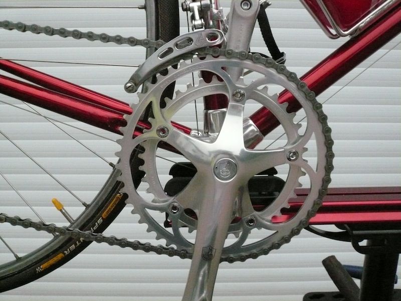

So with the cable stop repaired it was time to get rid of the Stronglight cranks that I had fitted as a temporary fix. I had managed to source a NOS Campagnolo Athena crankset that are more fitting for the Alan, so today I fitted a new Campagnolo BB and the Athena crankset. I took it for a quick 10 miles tonight and am a happy chappy.

nice ones 47p2 you seem to a have a nice spread of bikes there ! would you please coment and run comparisons
on handling and comfort of each

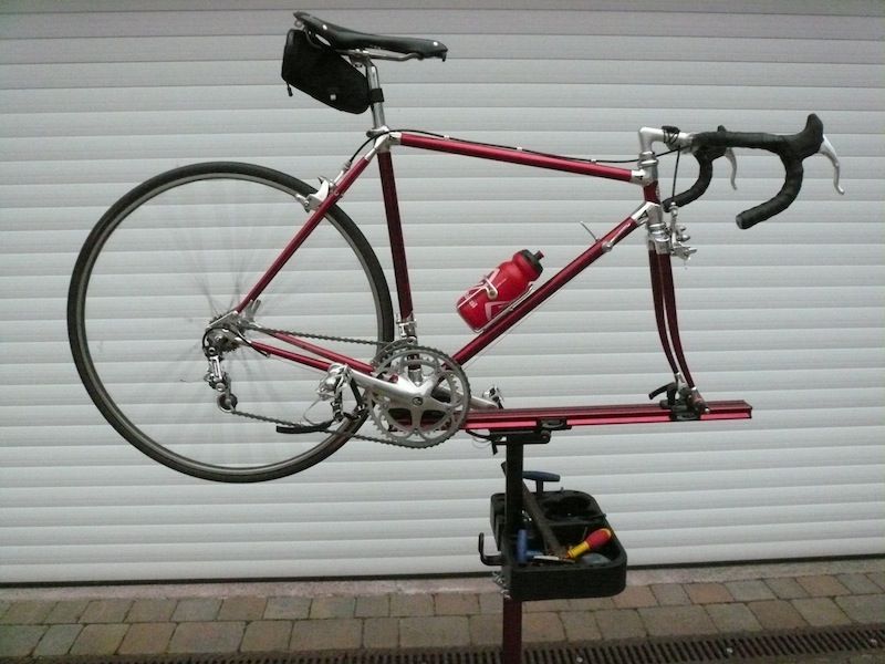

also i do so like your work stand ,how much where from, cheers
The Feedback workstand was given to me as a present, really like it as it means I don't have to clamp tubes or seatposts
