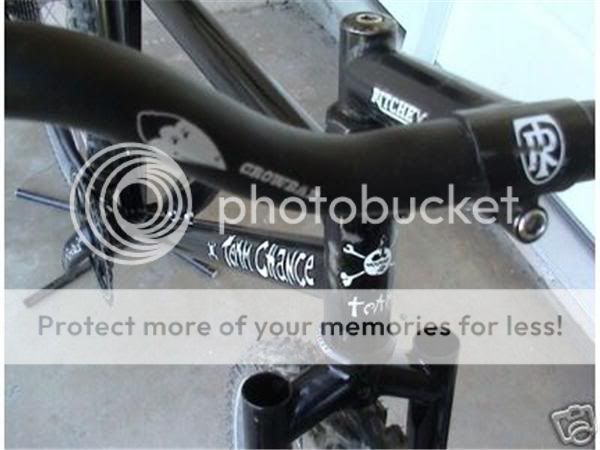

Actually the bike isn't a FAT, but it is one too ...sort like
To my information frame is issued by Canadian FAT importer. It is a Japan made frame labelled Team Chance. Chris didn't like it, but I do not know whether he disapproved it. To me the later is pretty crucial. Anyway it hasn't FAT DNA like the Yo, Wicked or Buck have. It is made overseas and typical FAT features like domed stays are missing.

Team FAT pics (another, not the eBay one):
Tange Struts fork: Also the Buck could be ordered with Struts. Yo and BOI fork were closed at the top of the blades were Struts had plastic caps(removed on this bike). Struts have curved blades, Yo and BOI straight.

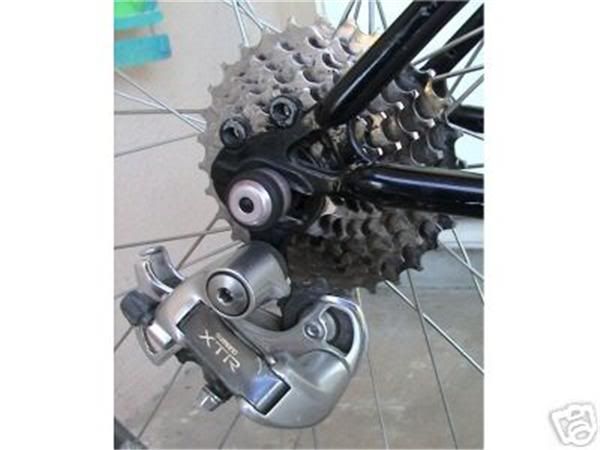

A seatube this long beyond TT is really un-FAT
No domed stays! Way smaller diameter stays at that point, but that could also be because they are tapered (can't see). Fat stays of course aren't tapered. Not as neat looking dropouts with 2 eyelets.
