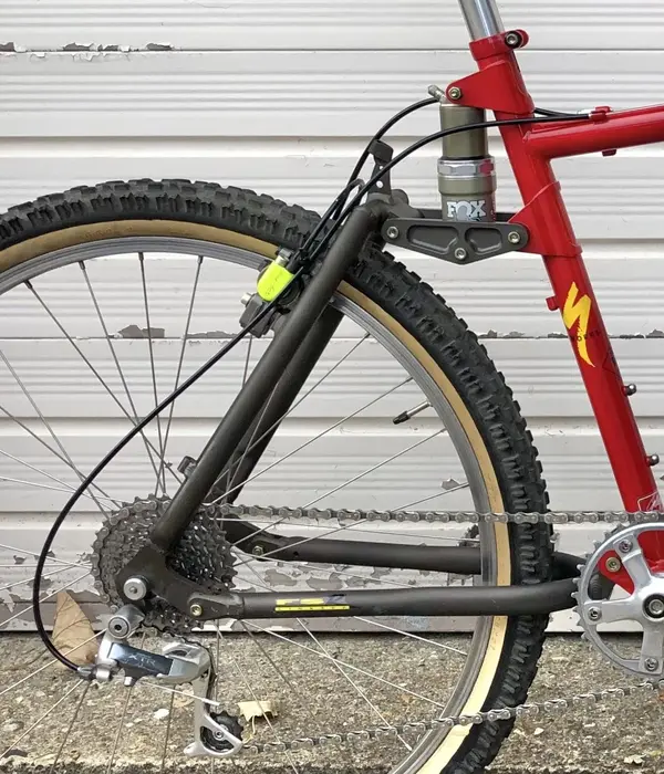

I’ve been wondering the same. The JMC FSR 1994 i was trying to replicate, looked to me to have full outer rear derailer cable cover, but I can’t quite see if it goes all the way or part way and then I was wondering why and how best to fix, ended up half and half and looks/works ok it seems.
I chose tiny zip-tie to the cable boss.
