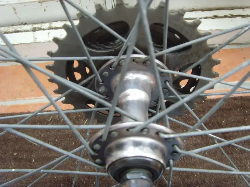

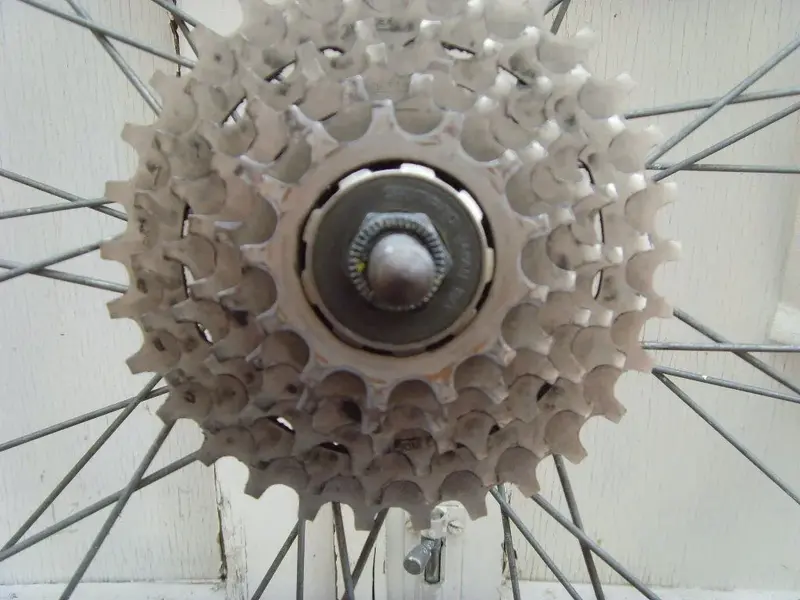

o.k you lot what is this wierdness and how do I change the cassette/freewheel ?
it's a shimano exage mountain fh-m540. The bikes over 20 yrs old, I assumed this would be a freewheel but it looks like a cassette type without a lockring? beats me...

Thats a UniGlide freehub.
Same principle as a HG freehub but instead of a lock ring the smallest cog locks the cassette on. You'll need two chainwhips for it, one to hold the block/freehub, the other to go on the smallest cog and unlock/unwind it.
thanks for that, most usefull. Can I get a replacement easy enough?
I got 2 chain whips So I'll give that a go.
http://www.sheldonbrown.com/k7.html#uniglide
Uniglide cassettes are quite hard to come by now, especially in wide ratios. The good news is that if you can get the top, threaded sprocket off, the rest of the cassette can be disassembled and you can flip the sprockets to double their life. The threaded top sprockets are very hard to find though.
Yours doesn't look all that worn. Why do you want to replace it?
It's normally possible to replace a Uniglide freehub body with a Hyperglide one that will take modern cassettes. If you want to keep the wheel, that can be a reasonable way to go, but unless you get the parts cheap and do the work yourself, a new rear wheel can be a better bet.

the 2 smaller sprockets are worn and the chain is skipping quite badly in these gears, it's quite un-rideable.
I did want to keep the wheel if possible as I don't have much more money to spend on this project. So like you say I'll have to get the bits cheap. Thanks for your help. I found some information on the sheldon brown site too which supports what you say about changing the body to a hyperglide. food for thought.
The freehub body swap is easy if you are familiar with rebuilding hubs. A decent LBS should do it in under an hour.
I got the cassette off o.k with the 2 chain whips and reversed the sprockets ( what a great idea, no special tools req. and reversable sprockets) I dressed the top sprocket with a file. cleaned it all and re-fitted it.... Still skipping. the shifter is in friction mode so it's not the indexing (is it?) moving the shifter whilst pedling along does not improve the situation.
I've changed a freehub body before on my 9 speed and am familiar with the ball bearing and cone set up in the hub so I should be o.k changing it.
My question is, am I looking for a 6/7 speed freehub body or will an 8 speed fit, just curious about the length of the body itself?
thanks for your help everyone.
Your chain is now seeing effectively brand new sprockets, so it may be that your old chain's pitch is now too long for your cogs. It generally pays to change the chain when changing the cassette.
You could probably fit an 8-speed body (the splined hub/body interface is the same for nearly all Hyperglide hubs), but the wheel would need a little respacing and re-dishing. It usually pays to match the right hand cone and spacers to the freehub body, which can make a cheap donor hub an attractive proposition when upgrading an older wheel. Newer hubs tend to use a labyrinth seal with a dustcap on the cone. Older hubs usually have a piston-ring type contact seal on the cone.
Personally, I'd probably stick with a 7-speed body.
