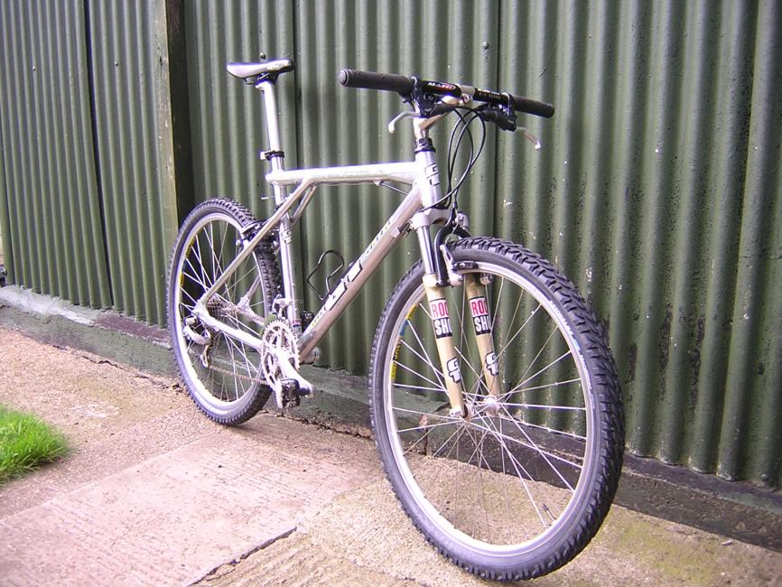

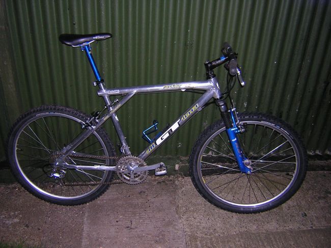

The rear brake mounts are too low for the U-Brake that would have been original equipment - the mounts would be within a cm of the rear bridge.
It has a replaceable mech hanger - cant see what sort, if its a single bolt it is later than '95
The cable guides are wrong - Pickles early Zaskar has them riveted to the downtube as a CNC'd block, my '93 has the same CNC'd block welded to the frame. The rear canti guide is also riveted on the early bikes and my '93
