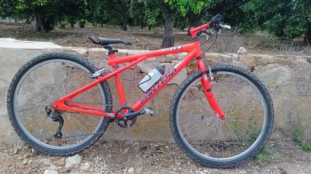

It's taken a while, but we finished this at the weekend :) My 9 year old has done a fair bit of the building himself and is well pleased with himself and the bike! There are still a few tweaks to be done - hubs need a proper going over, headset needs changing, and maybe the brake levers too (went with the old canti on the front instead of a V in the end, levers with a longer blade will probably work better for him). We went for a ride on it yesterday and it fits him great - he liked the ride a lot and is already much faster than on his old bike :)
And the paint isn't blotchy, it's just the effect of sun and shade on the fluo orange :facepalm:
Ok, so 6 years later, looks like the images have been photobucketed (but I can still see them), and this has now been updated and passed down to my youngest who is now 10. Swapped out the chainset to a Paul Milnes Cycles 155mm with a 34t NW ring, basic Shimano 9 speed mech and shifter to keep things simple. First ride this afternoon and he loves it!
