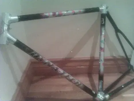

My new project-building up a Dynatech 2070 roadbike.
modern build
reynolds 2070(653)
mavic aksium wheelset
Vittoria Rubino
shimano 105 10 speed
ultegra chainset
ultegra rear mech
105 front mech
tiagra calipers
itm seatpost
charge spoon saddle
3tt quil stem
ill post up some more pics when I start the build-still waiting on the stem calipers and cassette to arrive

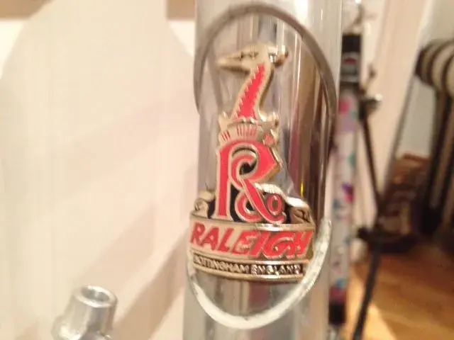

Put your camera / phone on something solid and this would come out great. These are great frames and looking forward to seeing it built up.
yeah excuse the fuzzy pics-Ill get some better ones when I start the build

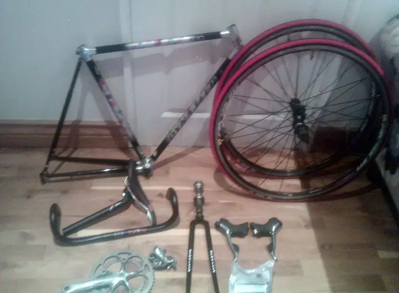

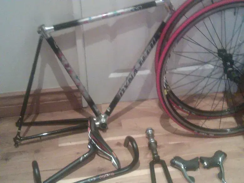

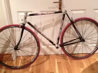

wheels brakes and headset on...little way to go..

Take care with the rear wheel. The frame was set for 126mm OLD hubs. If you're carefull you can get 130mm OLD in, but the mono-stay may react like the wishbone of a chicken if you try any more. :facepalm:
I hope not-!
Was running 9 speed before so its 130 set now anyway.Ill be sticking a 10speed on-looking forward to finishing it now. Took it down to lbs to have the headset fitted and the guy was all over it. Change from the usual alum or carbon stuff they see...
Love to see a catalogue for this model. I believe its 92ish.. Ive seen another one with 701 on the top tube but no idea if it was the 701 or 700?
The bottom section of the wishbone is cast. Hence the warning. It was not designed to be opened up, but you may get away with it.

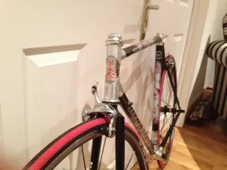

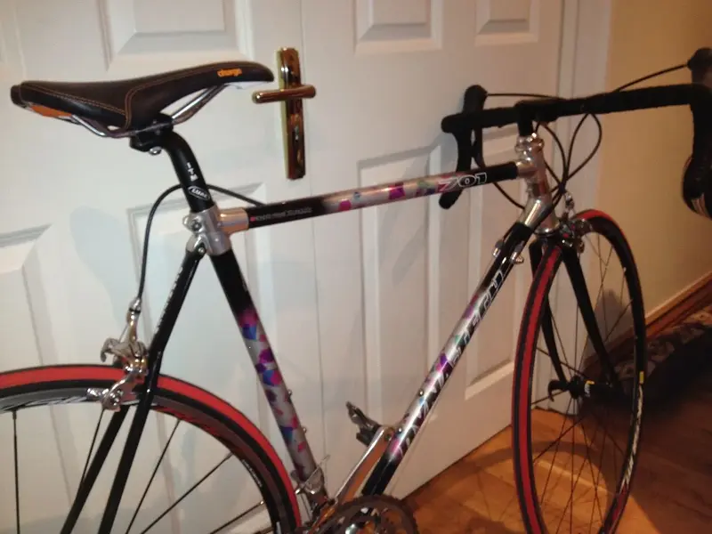

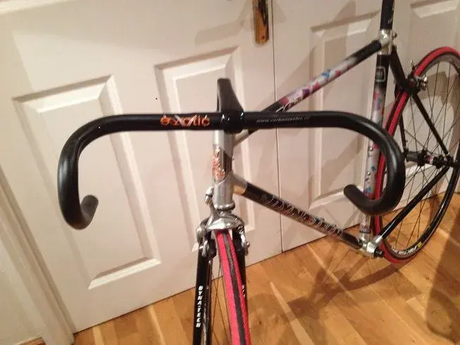

finito
finished article
Seems light enough I guess sub 22lbs built up with pedals maybe 21.5lbs
I wonder will it ride like the titanium ones..
Just have to ride it now-typically the weather changed for the worst....
