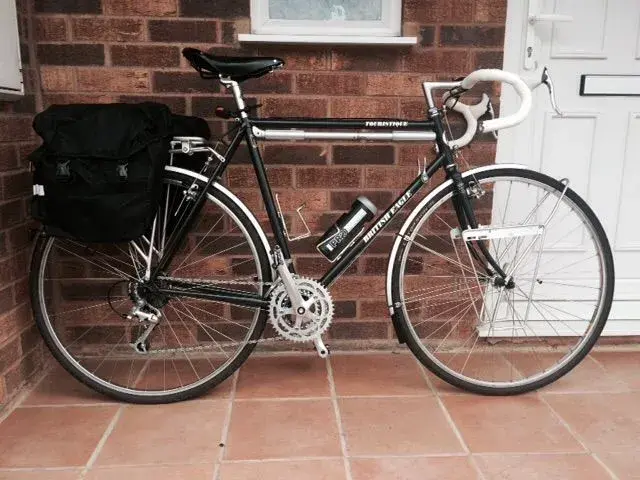

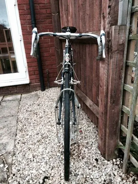

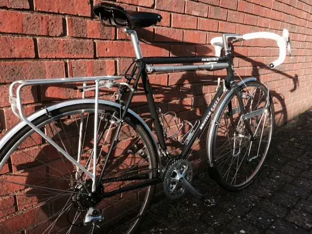

Here are a couple of images of the bike as it stands now after its restoration was completed last week.

2. That straddle wire looks much higher than it needs to be. Shorten it and your brakes will get better.

PS - I'm not so sure my straddle wire is too long - maybe a fraction only. Sure if I had low-profile cantis it would be miles too high - but not with the very wide tektros I have. The wire is almost 90 degrees to the arm's pivot-line when the pad hits the rim - so thats about as efficient as they can get. Certainly they feel good.

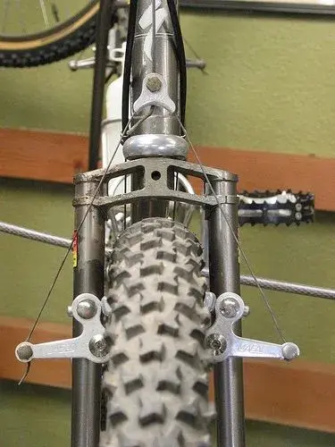

Black Mountain Cycles has a good online article about setting up canti brakes - and the image below from their site showing the 'optimum' straddle set up for wide-style cantis is pretty similar to mine.

No, that's miles too long. Still, they're your brakes, so set them up however you like. :-)
