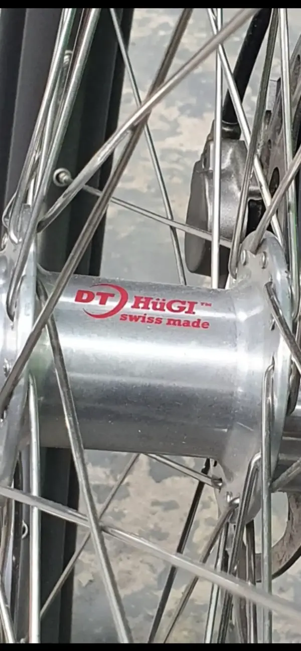

Hi guys,
Been looking at this hub.
Can’t find any info so hoping someone can enlighten me.
Does this hub have a 20mm axle kit to change from the existing QR available?
Thanks
Pretty sure not.
I don't think the bore is large enough.
You could pop the end cap off, read the bearing number, then see if you can find a bearing listed with same thickness and o.d., but 20mm I.d.
If that's the case, you can set it up 20mm with suitable spacers and dishing.

I’ve seen the one I’m after so I’ll probably just have to keep searching. As you say the bore might now be large enough compared to the one needed

They enlarged the dt hub body specifically to carry the larger axle.
This implies the old one wouldn't take it!
Not to say its not possible:
There are ways you could fit the hub - somewhere in our stock there's a funny adapter with 20mm ends and a qr skewer through it😄
Better get the right hub though👍

Many thanks
