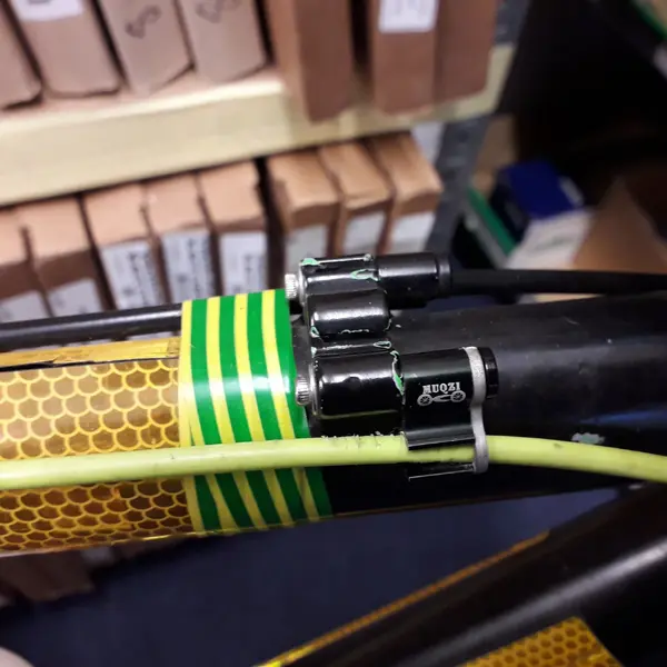

I have been using them on my commuter bike for the past year or so so i can run full length covered cable to my gears and disc brakes and they dont show any signs of rusting or corrosion. they work very well as long as you get the type with the little metal arms that hold the cable in the adaptor.

these are the ones fitted to my commuter bike. its a 1998 Giant ATX830.

Ahh, these look to be alloy main body which is nice, the cable clip might even be galvo which would be cool too. Will have to look out a set for the LTS as a more durable/elegant solution to hydro disc routing.
