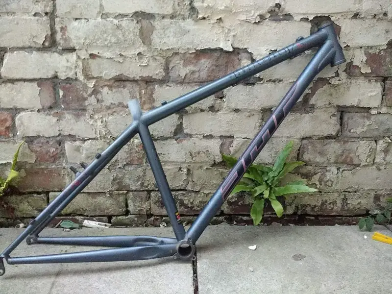

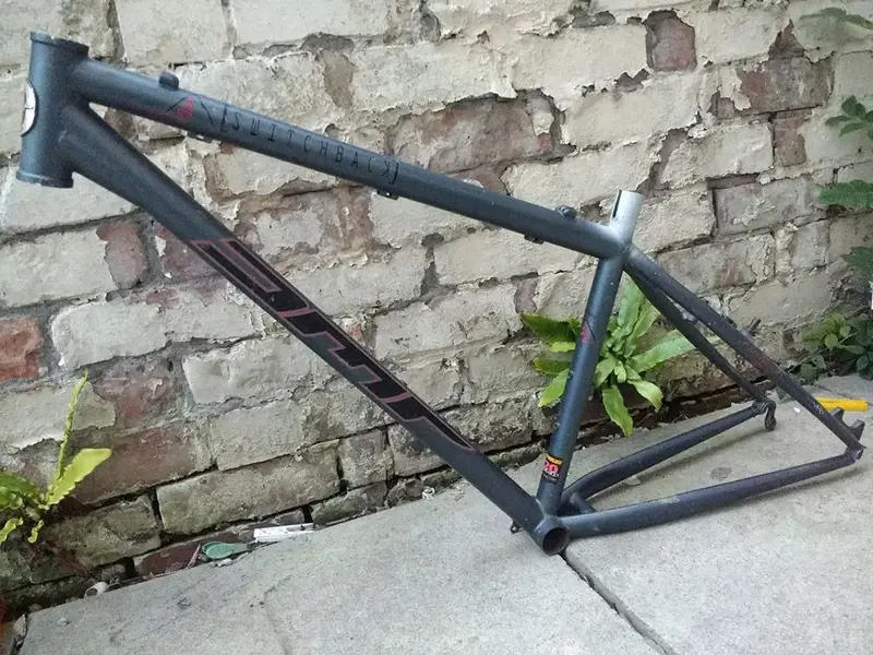

The first Switchback wasn't meant to be for me and although fun the 16" was a short reach so when a mate found an 18" NOS frame hanging on a wall of a shop, I couldn't stop thinking about it and eventually gave them a call. They are a really nice frame design just to look at and a fairly buttery ride. Some crumbled badly, legend has it that the later ones without ISCG mounts were makes stronger in the downtube, I'm hoping that's true and does feel fairly stiff.... Switchback shop.jpeg
Behold this near mythical beast!
:LOL: :cool:
Possibly one of the least tough DMR bikes intended for XC and trail. Lots of stories and reports out there of breakages, possibly just misused. I have a Kinesis Decade Virtue too and those were reported to crack around the seat tube top, mines OK, so two mythical beasts!
I'd just decided that my Trailstars and Omen are to small for me really and might be ending up sold, then I found this. It is also too small especially as an XC bike so It's going to get built for my long suffering lady - she doesn't know yet of course! :LOL: :LOL: Geometry is 71 and 72.5 degrees same as Trailstar but 11mm longer TT, playful 419 chainstays, taller BB.

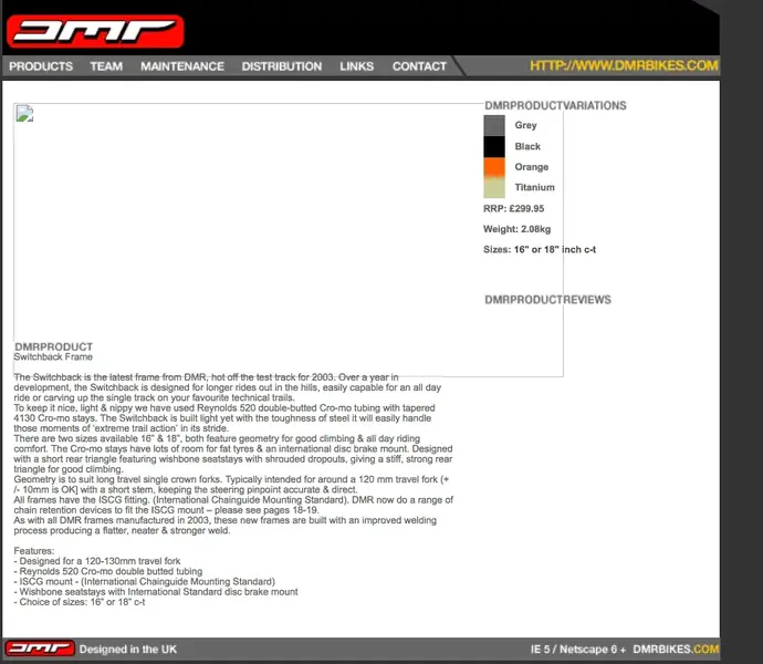

2003/4/5 model? the later ones were Reynolds 525 and no ISCG mount, mine is a sort of bluey grey colour in Reynolds 520 weighs less than 5lb!!
First of all Powdercoat? Seems a shame but would look great all tidy and nice or enjoy the patina? :?: :idea:
Build wise, 2005 Reba U Turn 115mm, BB5 brakes, wheels either build some browny 36h x317 into Hope F/Deore R from stock. or XM719 rims? 8 or 9 speed - undecided. 170mm or 172.5 Cranks needed, and thats it should be light and fun, simple and cheap enough.
Let us know if you have any info or ideas or even an opinion on a recoat.
Cheers

Nice frame
What is the seattube white paint about? That would decide if I powder coated it for me.
Build wise spot on

Thanks
I wondered that before I bought it. Close inspection so far it just looks a little lumpy. No big issue it seems. To know for sure I'll sand paper it down...
I was thinking more as the originality is always nice plus it's very understated to not get scallies after it. Hmm
The Reba's maybe needed for my Decade now as I have yet another DMR incoming but actually in my size that needs the Sektors.
So Duke XC may stand in on the spec sheet for now. Equally any of the above wheels.
I thought it looks like that rust protector paint or scorched from a stuck seat post?

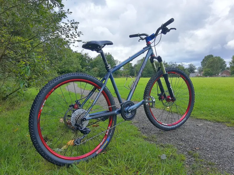

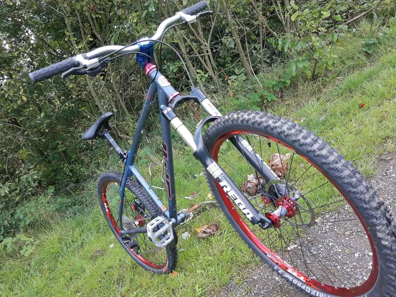

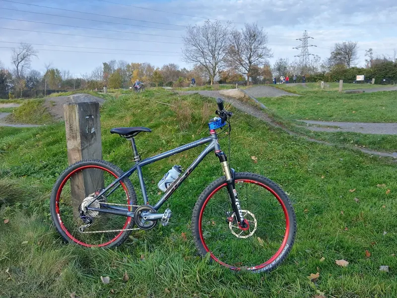

Realised I never updated this...
Collected a few parts, a retro modern 1x10 and other bits as they turned up. Ended up a Triggers broom thing as none of the old bike parts made it over! Frame got a little paint from plastikote, then a cut and polish.

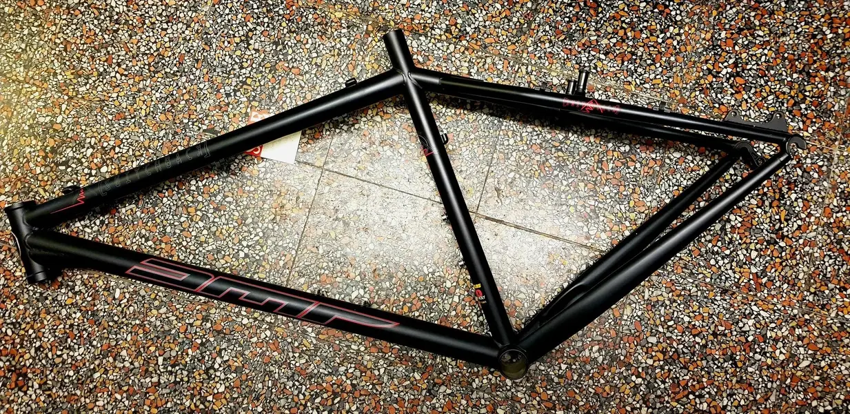

Turns out it was a bit big for my partner with the taller fork elevating the 16" frame up a few inch over the 60mm travel old Merlin so that's getting rebuilt. Despite it being clearly small for me, I quite like it seems more alive and fun than my Decade Virtue somehow. A mate discovered an 18" NOS a few years ago so despite not biting then, I've now bought it! Watch this space if interested! It'll still be tight geometry but offer a longer top tube and 2" of seat tube. In stealth black it'll be perfect for local stuff and should be a sensible weight for my aging dad bod to charge or cruise about on...

Thank you. It's nice to look at too. It's sat in my spare room now. Need to pull a few parts off to rebuild the Merlin but seems a pity to so quickly! I know what you mean. The new Trailstar is a good ride I believe but I can't get on with the design, they've also made the Rhythm 26" wheel and Aluminium but then maybe that's market trends. Almost bought a 24" Sect as they discontinued but missed it. Wasn't meant to be... I've got a 2009 era Trailstar to build but this Switchback is more suited to my current riding so it's queue jumping. Give it a good candy powder coat and a nice fresh build it'll be ace. Don't forget to share!
Oh and New Old Stock. 👍
