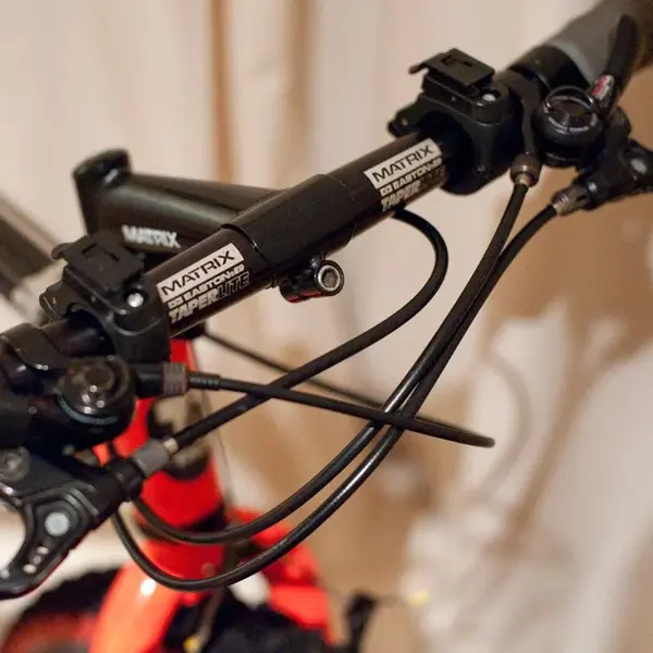

They are very easy to set-up and adjust, with 1-2mm clearance if desired. On-ride fine adjustment can be made using the suntour XC pro levers (1-5mm). In 18 years never had any problems. All the cables are original. Brakes removed every year for lub/cleaning, adjustment.

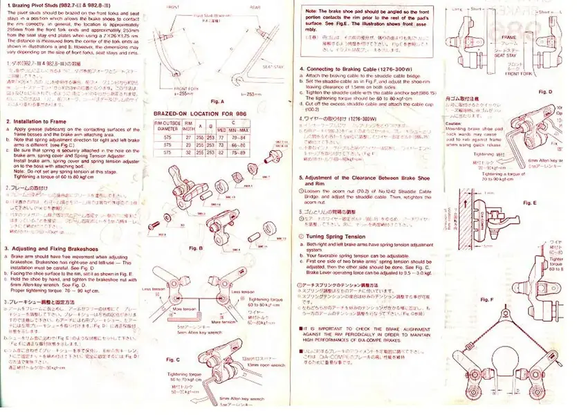

A web-search will give you the service manual with an 'exploded diagram' of the workings & assembly of the 986 brakes. I have attached photo of the original brake-set-up manual (japanese) with the o/e part numbers to help you.
