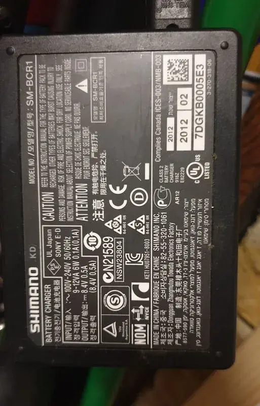

Cheers. Its older road tbh, but thought principles would apply to both. Assume I need ewire software. Are any additional wires needed? I've seen a special box is required for setup changes, seems a bit of a con if so but...
It's from a 2014 cannondale caadx black Inc. Ultegra 6770 I think 10 speed.

In that case, I think you need a special device to update the firmware.
With the latest internal battery and the latest charger - it's possible to connect a computer to the "brain" via the charger.
