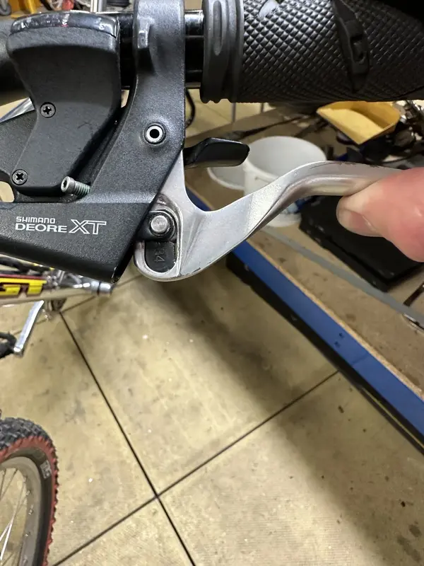

Got me a set of these to answer my own question.

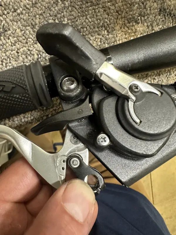

With the adjustment block removed from the lever and the cable anchor at its lowest point (closest to the pivot) gives you a radius of around 25mm. This is a bit to big for the canti brake. Meaning you don’t get great leverage and a weak brake.
I also found as you apply the brake the anchor roller runs back up slot and further reduces braking power. So I made little spacer to wedge in there and stop it free moving in the slot. Tacked then in place with some super glue.
After a test ride, still didn’t quite get the power I needed, so resorted to enlarging the slot closer to the lever pivot, with a round file. Now have a radius of around 23mm. And all is working well.
Can now happily run V front and Canti back.

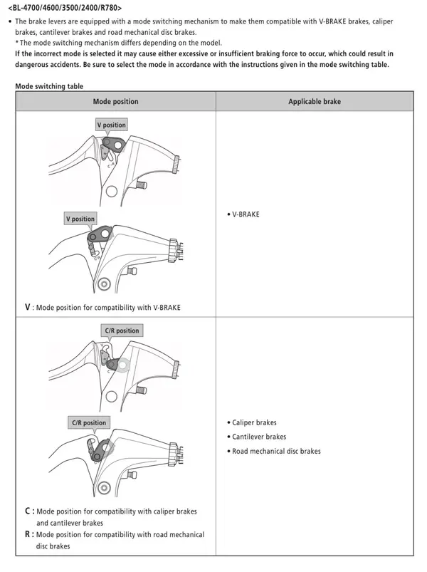

Shimano themselves on their modern Sora/Tiagra flat bar levers have a slot and a little chip to lock in two modes (see below). Long/short pull. I applied this same method to the old M379’s and it works. Job done.
