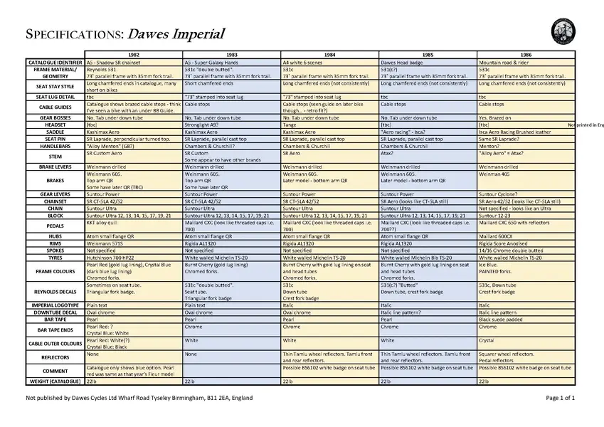

Dawes Imperial Specifications 1982-1986
ZG862
I came across a 1983 catalogue, so with the help of the invaluable https://dawescycles.wordpress.com/ I've done about as much as I can for now.
Itch well and truly scratched, but corrections and gap fills are more than welcome.
If anyone wants the pdf/docx that the attached came from, drop me a pm.
Cheers,
Z
PS/ Should any of Dawes' lawyers be watching and get upset at the homage to their 80's catalogue style, let me know and I'll take it down.

Malvern Rider":1uj59vzo said:
Thanks for this. I have a Dawes Imperial that has had a few parts replaced but this is perfect for resto reference
You're very welcome. I just noticed that there's an errant piece of text that failed the doc->pdf conversion but the info is as comprehensive as I know at this point. I failed to mention that the toe straps appear to be Dawes-branded Zefals. Incidentally, what year is yours and do you care to share the frame number?

Looks good. These 86 ones are quite interesting as it looks like Dawes tweaked the frame geometry slightly. The fork crown and brake bridge are both lower (I'm pretty sure Weinmann 405s wouldn't reach the rims on the earlier frames) which means that the down tube angle is slightly softer. The brake bridge is of superior quality too. I get the impression that they spent a little more money on the frame and so clawed it back by deleting the chrome forks. Did you notice the "73" stamped into the front of the seat lug? Not sure if they did this on the Mirage or Atlantis that went before but it seems common to all Imperials. I'll have to update my chart. Likewise, Galaxies of this era have 72 btw.
Whilst it would be fantastic to see it "restored" to original, I doubt you'd recoup the investment. Let me know if you do go this route as it might give me the nudge I need to do the artwork for the "Imperial" script. H Lloyd do everything else I think, though don't lose the head badge.

I got up close with a 1986 Imperial last week and made a few observations that mean that my table needs updating:
  • 1986's have a more circular fork tubing section that the earlier chrome-forked versions.
    They have Maillard CXC 650 pedals - probably the same as on most earlier models. These have adjustable cones but not the threaded dust covers of the fancier 700 models.
    They have the SR AX 144BCD chainset rather than the CT-5LA found on earlier Imperials
