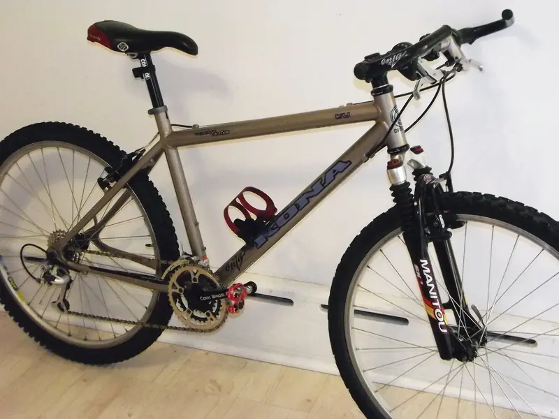

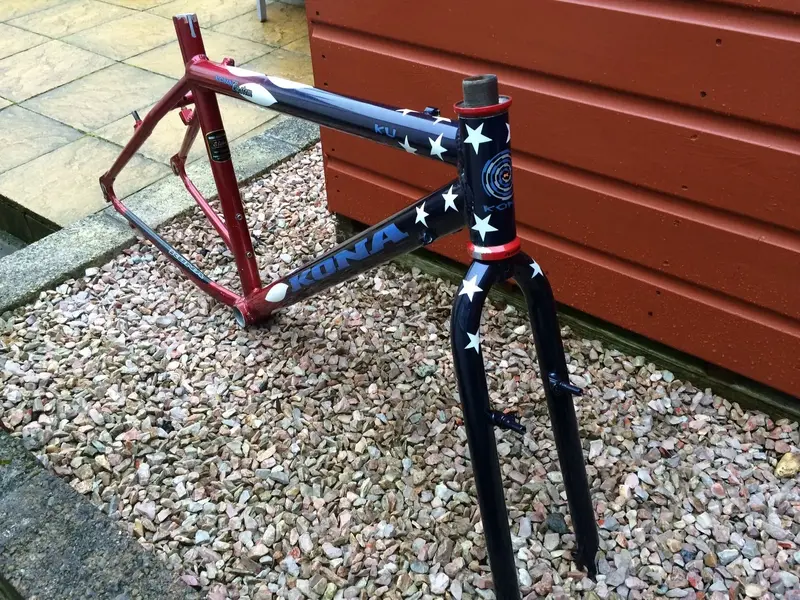

Here are two Kona Ku Frames made by Altitude in 1995 & 1996. They have the 1996 Cable Stop arrangement, and 1996 Livery:
KU0153 - welded late 1995:
K09606058 - welded ‘96 June number 58:

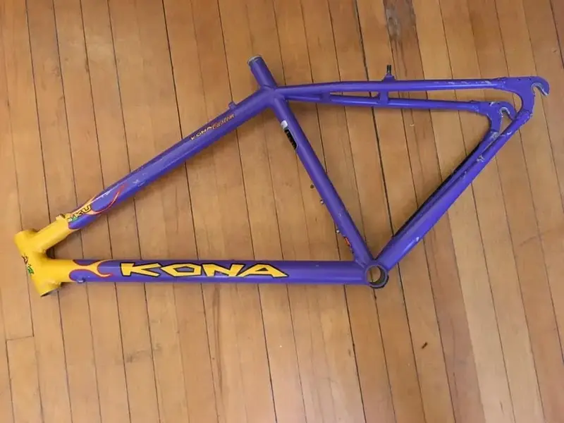

Here are two more Kona Ku frames made in the same month and year as Serial Number 58. Again they have 1996 Cable Routing, but are displaying 1997 Livery:
K09606064 - welded ‘96 June number 64:

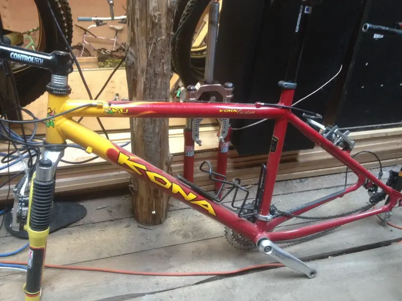

K09606065 - welded ‘96 June number 65:
The first two would be regarded as full on 1996 frames, but what about the second two?

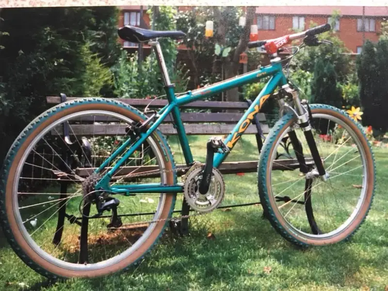

For reference see this last example of a 1997 Ku with full on 1997 Livery and Cable Stop arrangement:
KU9702085 - welded '97 February number 85:

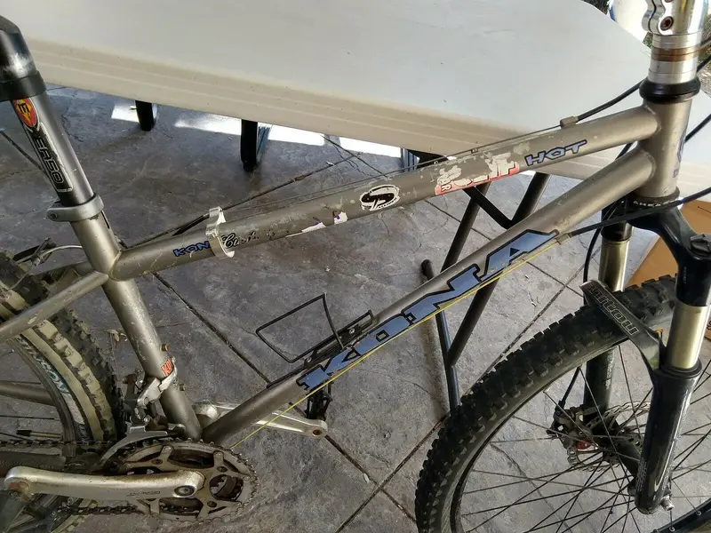

Tom Teesdale built the Hot for Kona from 1991 – 95 exclusively from various versions of the Tange Tubing. Altitude took over the contract to build the Kona Hot in 1996, and built them exclusively from Reynolds 853 / 725 Tubing.
See the example below of a Tom Teesdale frame built from Tange Tubing (see Seat Tube Bulge at Bottom Bracket), but it is wearing full on 1996 Livery,
TET 1882
What year do we call this frame?
