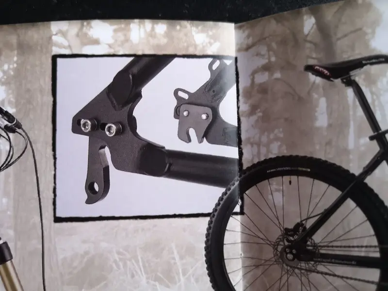

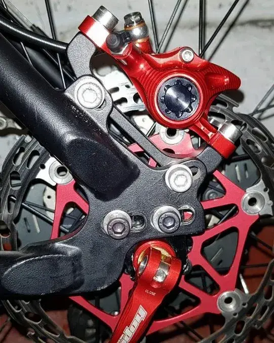

The dropout to stay attachment on mine is as per the white one but the actual style of dropout is quite different.
Can see them in this photo, albeit the sliders aren't attached.

The 2007 catalogue shows the caliper mount on the frame rather than the removable dropout, like my old black one above.
2008 catalogue shows the mount on the removable dropout.
2009 catalogue shows same mount but bb now has ISCG mount
2010 (as white one above) has caliper mount back on frame along with a brace between NDS chain & seat stay plus increase to 3 bolt fixing for dropouts & the use of Reynolds 631 tubing.
I do - but only the P7 extract for 2010 on the link for the P7 2010 in my signature in on here (that I know of). They're difficult to scan but I'll photo the P7 pages & add them here.
