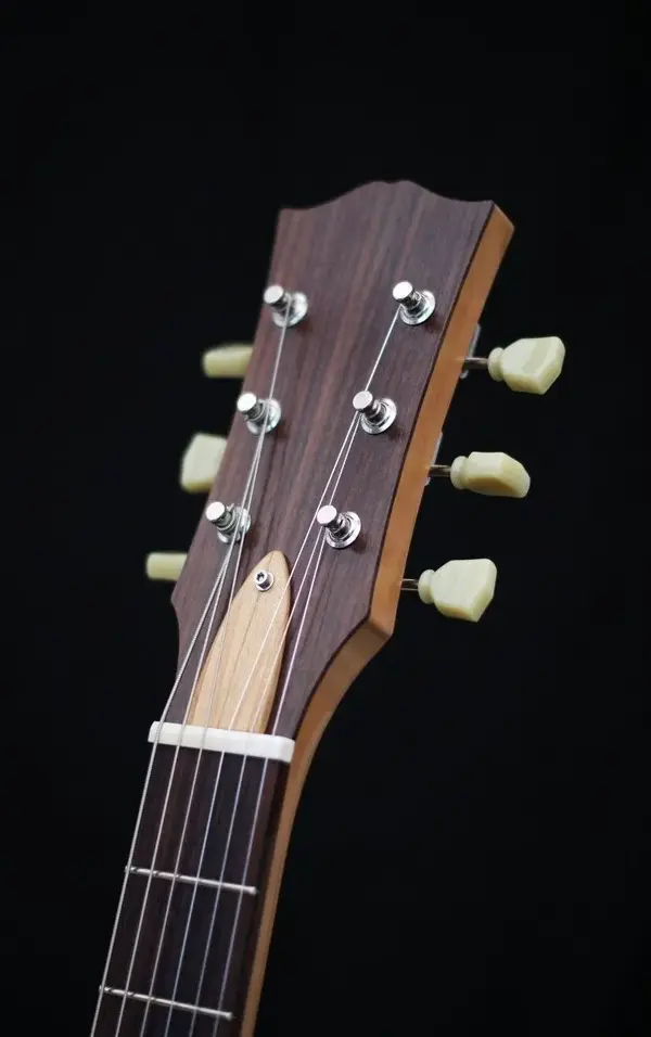

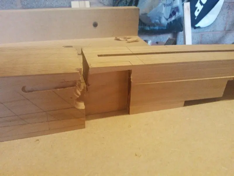

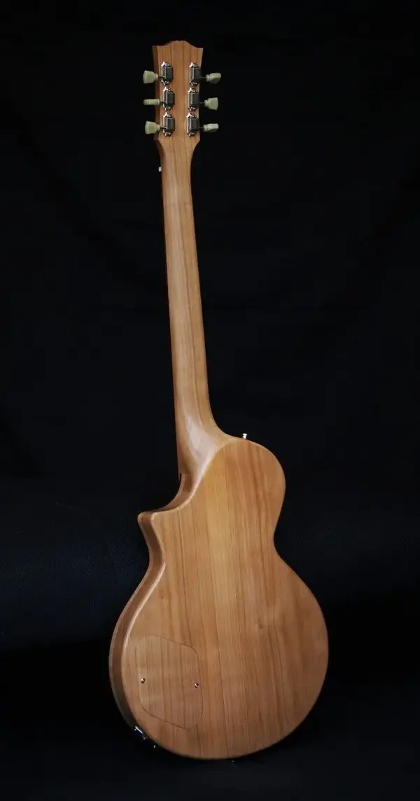

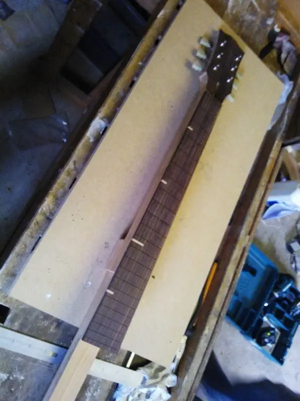

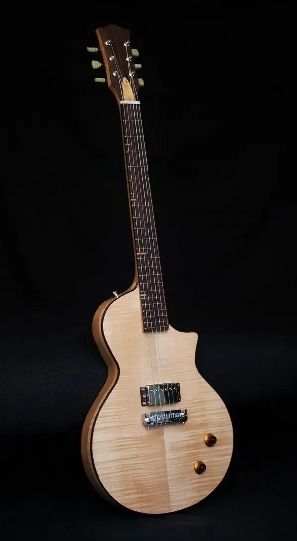

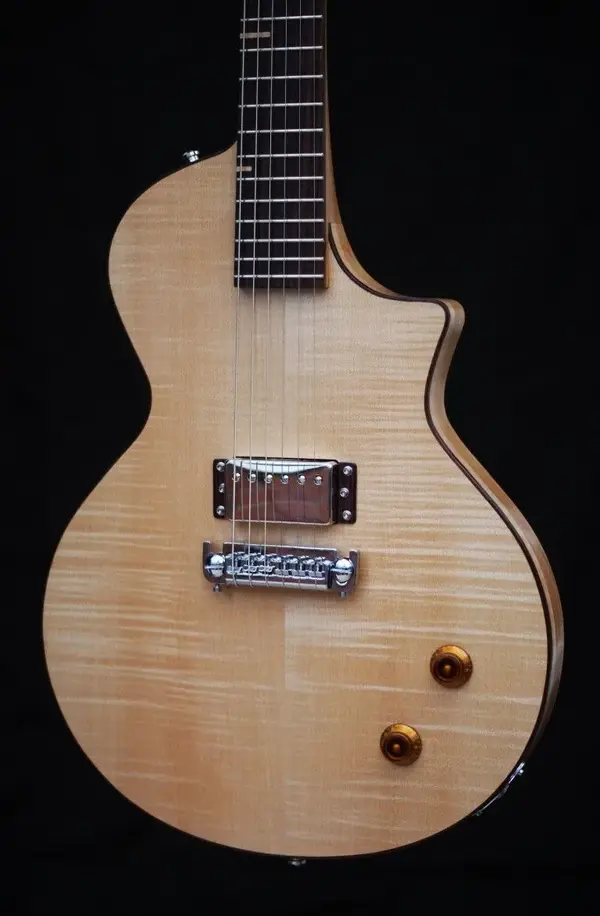

Everything was from ground up. No manuals or googling. Kept us on ours toes and was good for discussing ideas on how to progress. Down side was that we probably 'reinvented the wheel many times over'. However it was an enjoyable experience to do so. Our only compromise on the project was to get a pre-slotted fingerboard, which we probably still think was the right decision for a first build.
By far the most complex bit of design, marking out, cutting etc was the neck to body junction. It still baffles us as to how we did it.
Chose to run in some fret markers from the side rather than the traditional location in the middle of the fingerboard.
Dry set the frets, rather than glue. Did have some loose frets that required some glue.
Binding was difficult to bend around the tightest corner. Our bending iron was a paint striping hot air gun, heating up a copper pipe.
