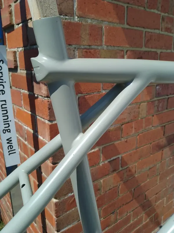

Top tube had two dents one 6" from head tube on top and one about the same from seat tube again on top.So a perfect opportunity to try my hand at rolling/massaging dents out ! Went well ...better than expected even,the one near head tube needed no filler and blended out with high build primer the one near seatube was way trickier as the tube ain't round...still I got to the point of just a fine skim of filler probably less than half a mm.
Now as I was mixing filler....hmmm....I thought what about blending all the welds smooth kinda like a fillet brazed frame? Yup didn't take long to like that idea....bead blasted all the areas and got stuck in....bloody hell it took ages to get that blended perfect roll 😆 doubt I'll ever do that again!

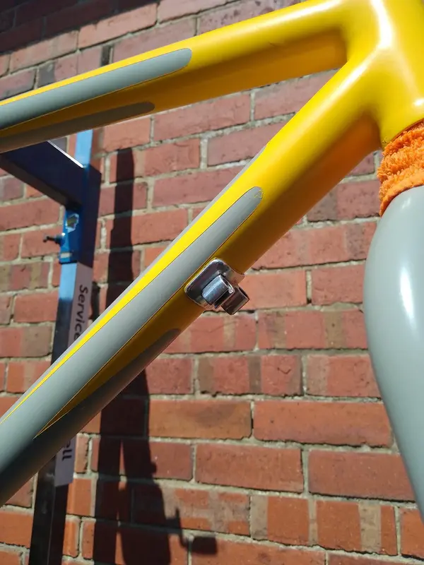

Deleting all braze ons and cantilever mounts ...I didnt want them... oh no....plan was for smooth and easy clean baby no nooks no crannies.
Tweak the rear dropouts for the new hub width.
And add a little extra clearance on the drive side for chainring choice.

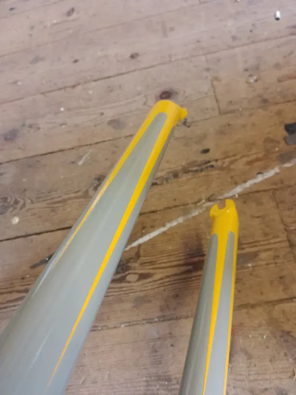

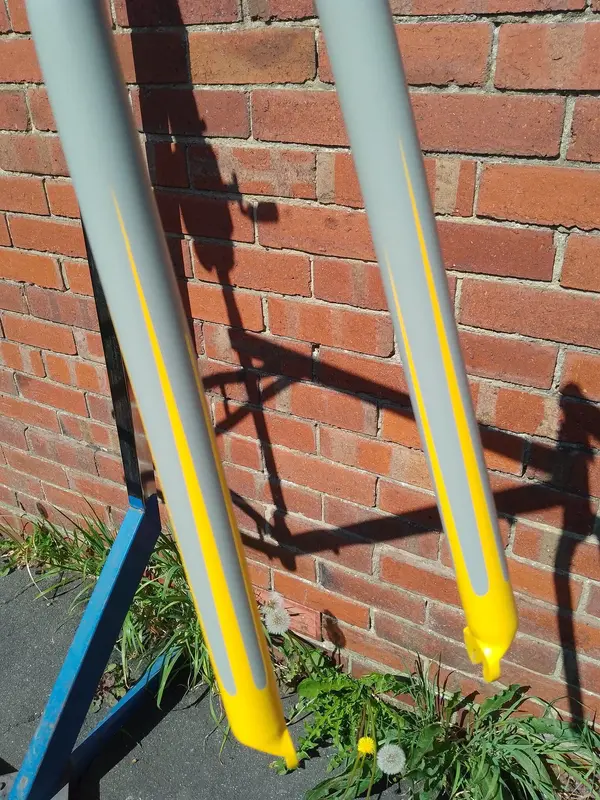

Different forks ...I fancied something straight as GT's can look neat with straights, got lucky in the shed o'shit and found some project two triple butted oooh yeah ....so very carefully removed the cantilever stud's again ...time consuming with a file,did need a little skim as I wasn't going to disturb the weld root as they're pretty thin there.....im ugly enough but I still have my teeth ok! 😊

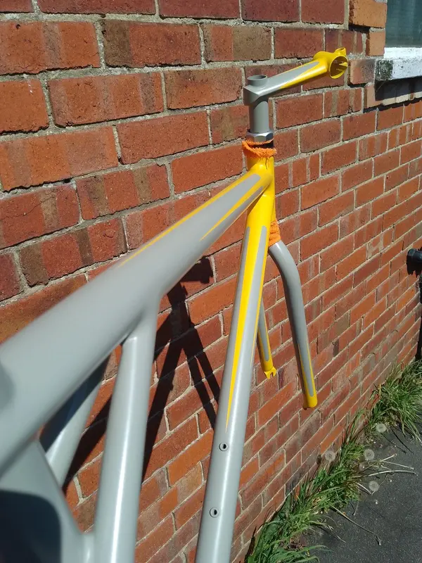

So i got the wet flatting done last night and fixed a couple of paint chips ....no idea how they appeared...grrr!
Today was going to be about lacquer... all smooth and lovely .... Went to the paint cupboard and there's only a quarter can of lacquer,bugger!
So stem and forks had first coats... there'll be 2 more to go on ....

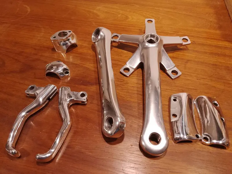

So as I can't steam into the frame it's bring out Betsy time....
Betsy likes to get filthy and buff...😜
Meet Betsy..

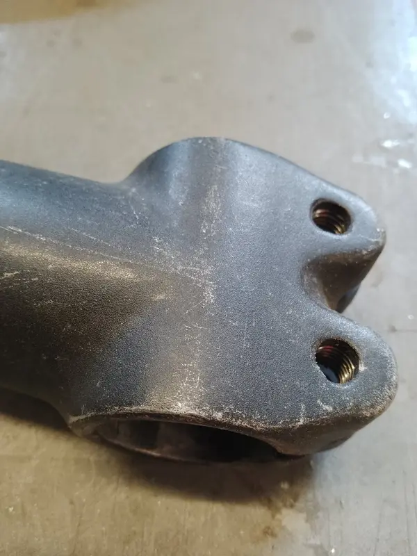

A little bit of filing and wet flatting on these...
And it's time to introduce them to Betsy's charm!

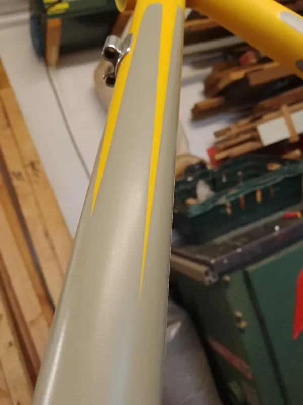

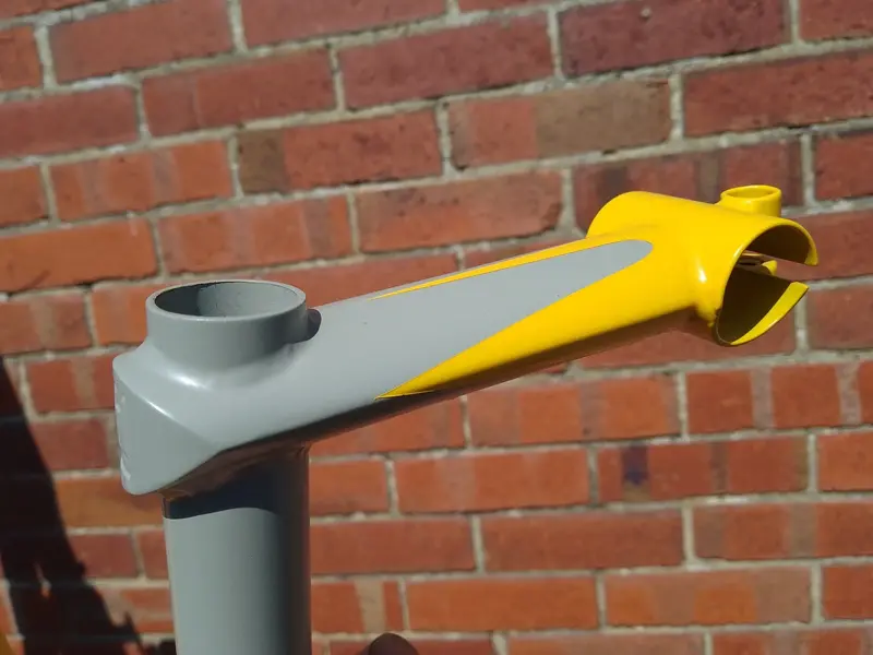

Today was lacquer day!
Today was not lacquer day!
I left the frame in the glorious sun to warm up a bit before going on with lacquer when I returned there'd been a bird strike...yup!
Birds shittzle dribbling down the downtube and of course it pickled it!
Both colours aswell...nice one birdie I owe you 😘
So I cracked on...
And somehow I've managed to pull it back!
I can just see a trace of the event...can you?
Itching to go on with lacquer now but that needs 24hr.. tomorrow it'll happen.

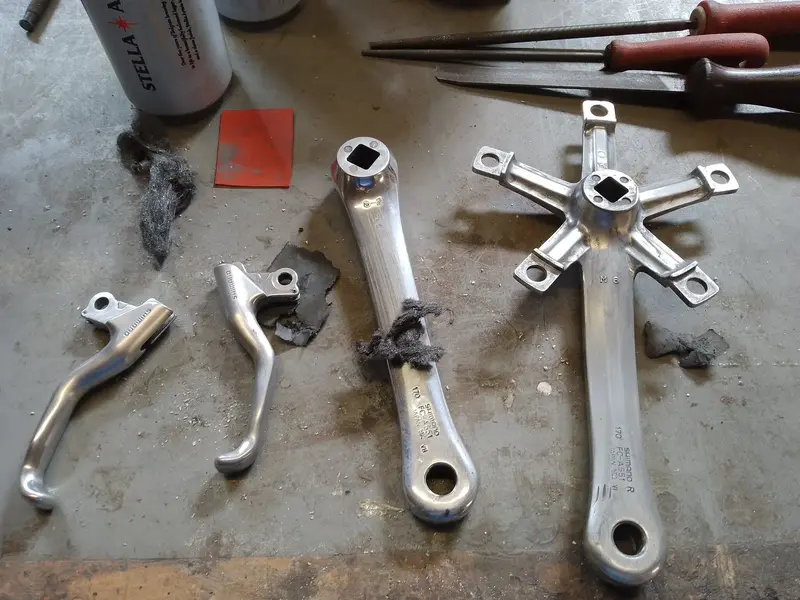

A little stem cap wet flat and buff,clean up some bolts.
A Norris mcguirter squirt on the brake lever clamp bodies and reassembled + lubed with PTFE.
Love these levers hands have spent so much time on these over the years any other lever just doesn't feel right anymore.

2 coats of lacquer on yay!
I'll wet flat tomorrow and hopefully as long as there's no more misshaps get the final one on.

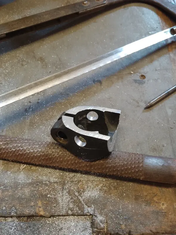

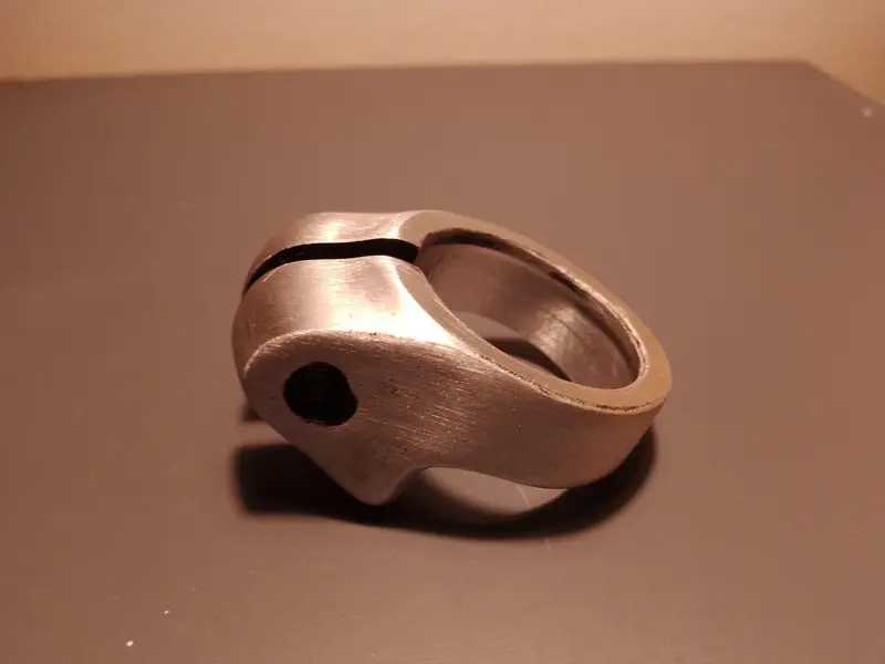

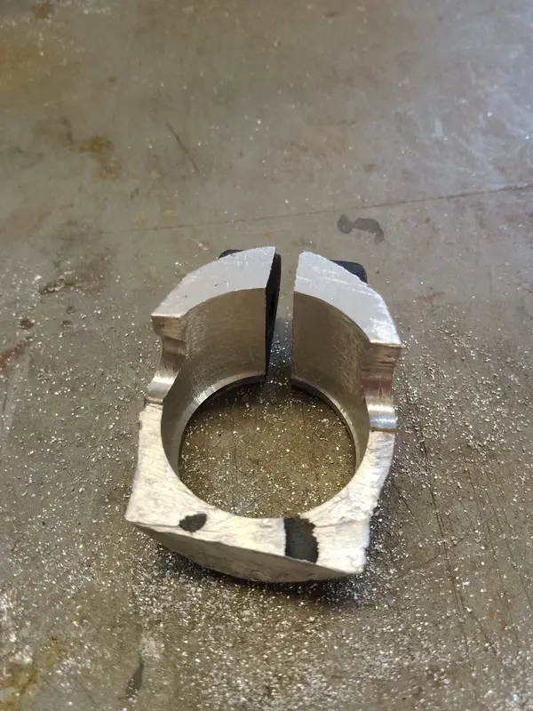

I'm gonna need a seat clamp....all I can find is the usual soft as butter stuff...with M4 or M5 thread...nah! .I don't want that I need something a little more stern 💪
Looks like I'll be going for a cranked steel seatpost in chrome so I'm gonna need to properly get hold of that seat tube
A quick rummage in the bin of sh!t.....
You'll do..come to daddy.....mmmm mmmm
Right you ugly b'stard off with half yer head!
The all important bit....the hole and register
Prettied up a bit...a few more tweeks to do then wet n dry and buff it up!
And that folks is another episode of faff!
