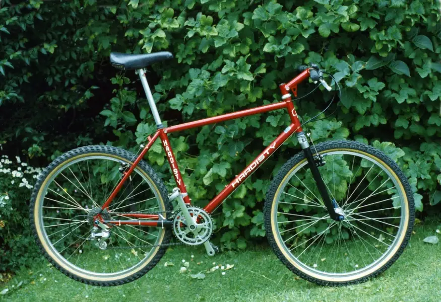

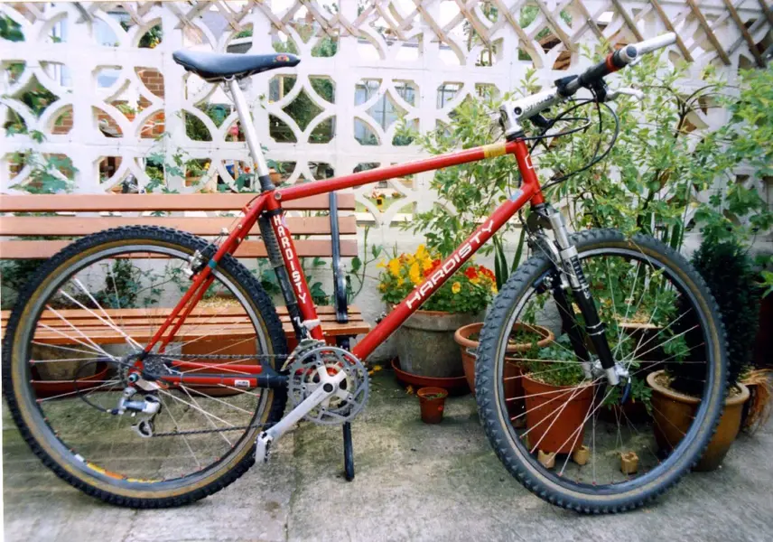

Here's mine (alas now a melted wreck due to a cretinous pensioner who thought it was OK to do 70 in dense fog).
'Sweetie' was built by Hardisty in Newcastle from Columbus Genius steel tube (so thin you could actually deform the top tube by squeezing it really hard between fingers and thumb)
She was finished in candy-apple red (red laquer ove silver base coat) and was a Bio-Racer made-to-measure job so I had to be measured up on a big jig thing - the inside leg measurement bar gave me an inferiority complex.
After getting the drawing faxed back from Bio-Racer (Holland I think) I specified a 18" seat tube, rather than the 22" suggested, an internal seat post binder, an open cable guide to the rear canti (think old Kona, but designed to be easy to disconnect and clean) and stem to my design.
12 weeks and much telephony later, I got the frame. :D
Beautiful,
BUT the 22 1/2" seat tube was back. :x
AND, a 58mm width bottom bracket (wot!?).
AND nasty canti bosses :evil:
So back it went.
8 weeks and loads more phone calls later...
Bicycle loveliness was mine. :D I polished up the components and started decorating.
Finished and time to learn how to cope with it - twitchy and fragile feeling. :oops:
But, I learned she wouldn't break and I adjusted to the steep geometry. I had a gorgeous bike that I loved to bits and rode as hard as I could.
:D :D :D
She got up-graded and I finally gave up on the Aheadset cos it never stayed adjusted - XT cassett headset and Ringle stem.
I went to Sachs Wavy shifters.
Then I got a Santa Cruz...
But I liked Sweetie more and went back to being fully rigid :D

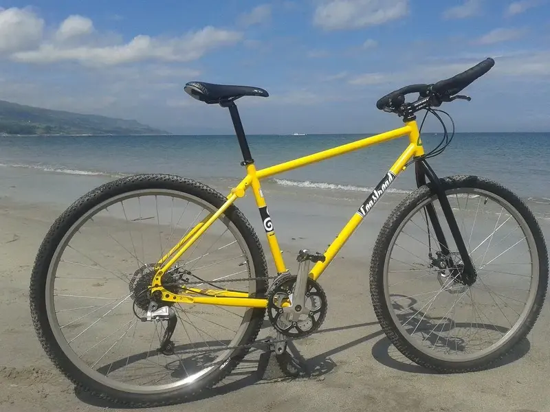

Had this Yellow Beastie recently custom-fitted and built to my own specification by....er....me. Shameless plug? Probably. Too modern for in here/ too 29-ery? Definitely. Come look me up when yer ready, Jimo :wink: :xmas-wink:

Ta Stewie-muchly appreciated! Yes, all done in my own head and drawn up on paper old-style, the Columbus tubeset came with straight rear seatstays so it was a last-minute solve to make sure I could run silly-wide tyres, without blowing my own trumpet (fnar :oops: ) It's worked out well so I'm designing my next ones-gravel grinding CX touring bikes-with the same seatstay design. More before christs-mass...
