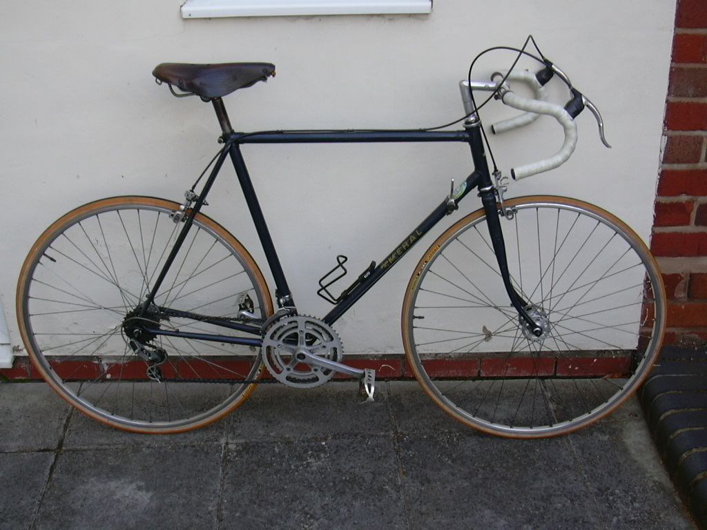

Picked this up locally over the weekend. Can't find much detail about it other than it was made in France in the 80s and has Huret gears. No idea what the tube quality is but it's surprisingly light at 21lbs.

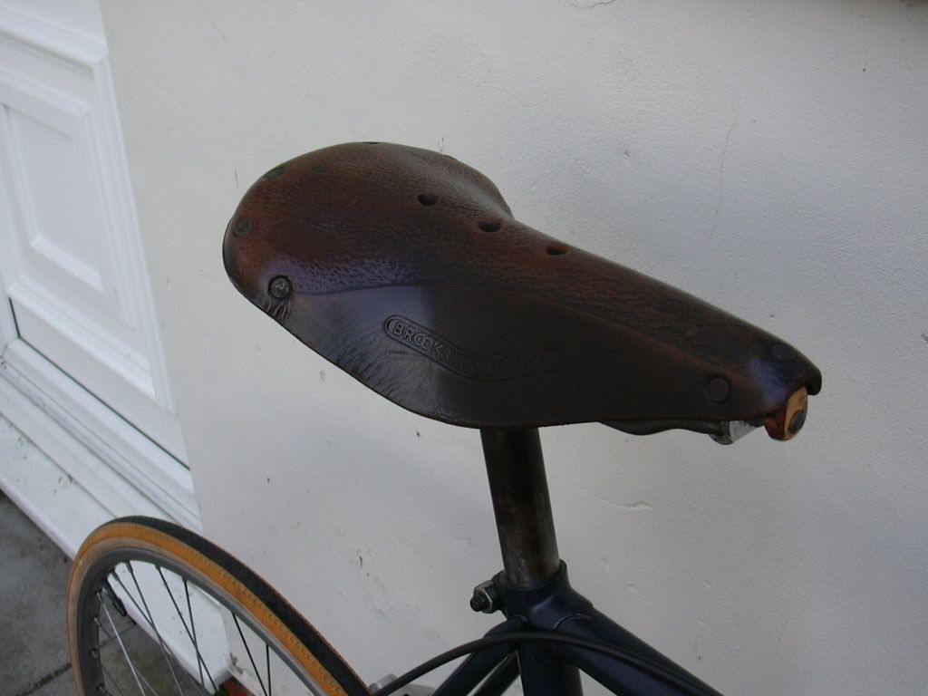

....and a nice Brooks Competition saddle :D
Went out on it yesterday and it's a nice ride despite the too skinny for me tyres. A couple of problems though...the pedals are horrible and my SPDs appear to be a different thread :( Also the brakes are dreadful, will some modern blocks help?
I'm off to my lbs to see if the cranks can be re-threaded but if I need to replace them (they appear to be odd ones anyway) what sort of options do I have if I want to replace the chainset for something a little kinder to my old legs?

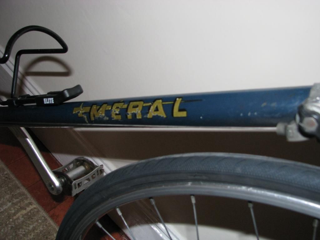

meral was a nice french framemaker from the "Angers" region in the country ( remember "la douceur angevine" from the poet Joachim du Bellay ) :idea:
He built nice roadbikes but was also renowned for his women bikes with a specific toptube which angled half of his length to rejoin the seattube horizontally
you seem to have possibly a mish mash of parts with some midrange Huret derailleurs

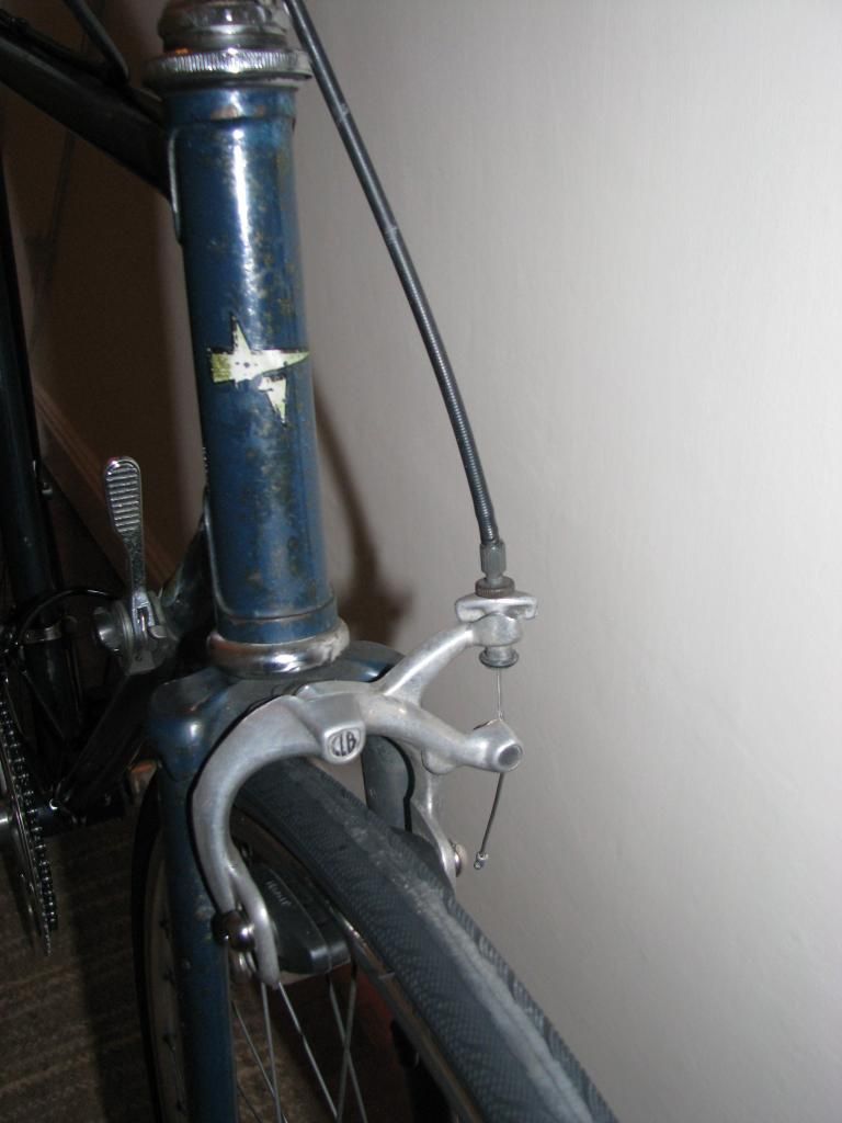

possibly some upper range CLB brake calipers - have they got a red dot ? if yes - these are the CLB professional which range between 90g and 140 g per caliper according to the version ! if not the red dot , then lower CLB
Looks like a solida crankset ? what is the engraving ?
Your wheels are probably some Normandy High Flanged ones on Mavic rims
If the bike is very light, then, its the frame which must be the "culprit" so maybe a very light frame :idea: :lol:
it looks more seventiish to me than 80's though
if it is the case, it deserves a stronglight chainset and better derailleurs like simplex :wink:
your bike is most probably with all the threadings in french format - hence your pedals issue :idea:

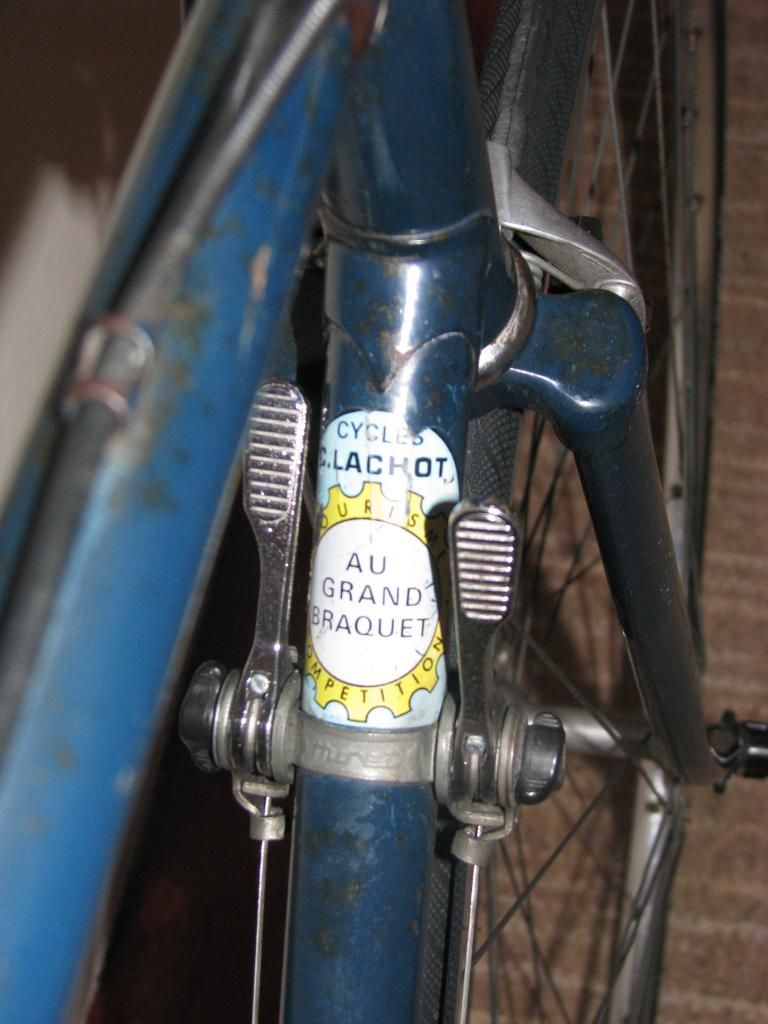

hello there, any chance a pic of the d tube badge
saddle is in really good nick

Thanks for the info, much more than I managed to find :) The hubs are indeed Normandy and it looks like I have the lower spec brake calipers.
Saddle was a bit rough but came up nicely with a good clean and feed and some aluminium foil to clean the rails. Not sure if the tubing is Vitus, how can I tell?

Anyway, rant over. Here's some pics I took after a good cleaning and having put some proper sized tyres on.
cheers, i think those brake calliper's are cool ! im good at creating work here so i wont ask you for a pic of what
the head tube badge should look like.not that i have a badge fettish or anything :wink:
your brakes
