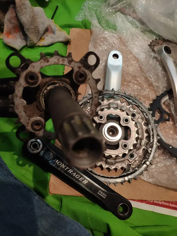

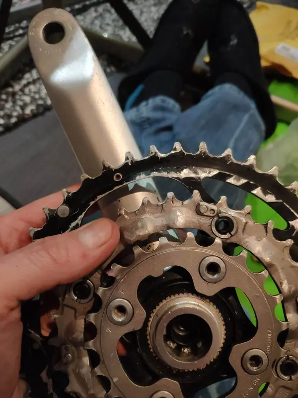

I've had my Kona Caldera powder coated and I'm assembling for the first time but I'm stuck.
I have a hollowtech BB which I have fitted ok. I have a Shimano M751 crankset, but without axle.
I also have a Bontrager 7050 crankset with axle, but it doesn't look compatible with the Shimano. I'd prefer to use the Shimano.
Can anybody point me towards a compatible axle please?
Thanks.

Thanks! This is a minefield, but fun :)
The Bontrager is indeed GXP, so I'll have a look for the types that you mention.
You can get bbs that will work with both ht2 and gxp standards. Gxp needs an adapter on one side to work with an ht2 bb. You can buy adapters but it is marginally more cost effective to buy a bb that comes with one. Try searching on ebay for ztto ones. They are decent quality and can be had pretty cheaply.
As mentioned, the original hollowtech bbs (essentially the axle and bearings for your xt cranks) are getting harder to come by.
