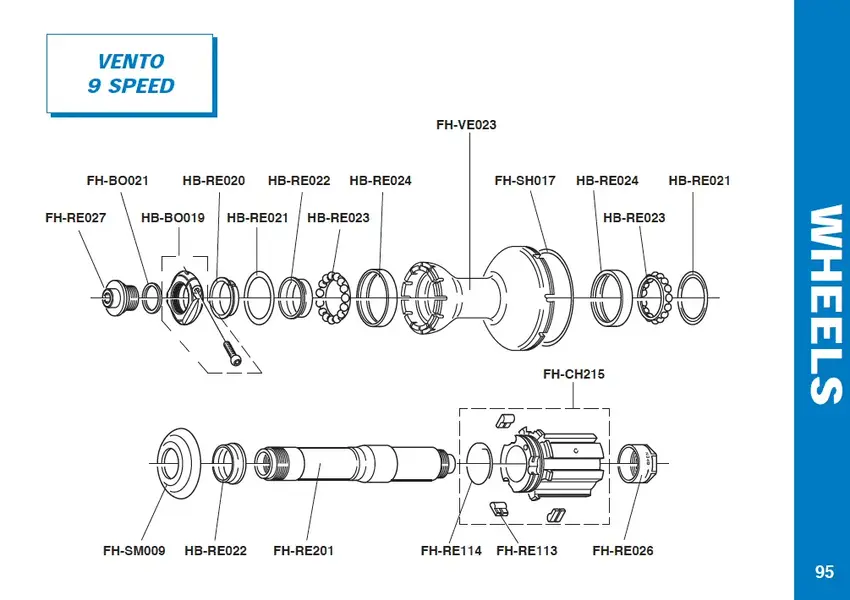

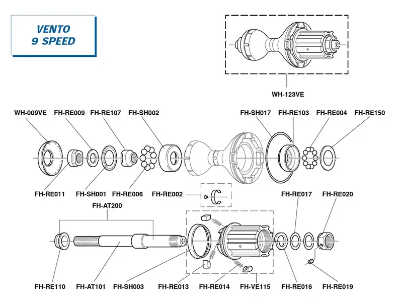

This might be of some help??

Thanks, that might help but at first glance those are 96 or later ventos, with the HPW type hub (with a "bulb" shape instead of a more traditional flange on the NDS.

Be very careful if you do buy a hub, as all the later hubs used larger diameter axels!! this is the 1999 spares list for a Vento rear wheel. All the early hubs used a much smaller diameter Axel as in the first 2 diagrams I posted.
Also none of them are held on by a 10mm allen key, I think BigFoz is getting confused with Shimano rear hubs?
What holds the F/W body on is the part FH-RE026
BigFoz":2rzslgpo said:
8MM then? Was a big one.
Look at the diagrams there is NO Allen key 10mm or 8mm bolt holding the F/W body in place on the early cassette hubs.
the lock nut/axel spacer FH-RE020 which screws onto the axel, and then the tiny allen screw FH-RE019 that holds that place to stop it coming undone.
Once that part has been undone & removed the F/W body just slides off the axel.
