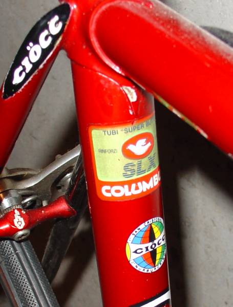

I'm interested in a frame that is supposedly a custom built (ie unbranded) SLX.

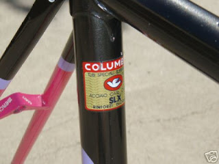

I've asked for some more photos, but in the meantime, does anyone recognise this photo as being a genuine Columbus style? Although I can find decals with "Columbus" at the bottom rather than the top, they all have the Dove, which this doesn't appear to.

Looks like a kosher early SLX transfer with the dove scraped off by a framefit pump....
It seems to turn up on bigger manufacturer's frames, (like Ciocc, above). Perhaps it is a cheaper tube combination (one SLX main frame tube?) to enable the factory to put a classy label on the frame.
IIRC, all the SLX transfers which came with loose tube sets for custom builders were of the 2nd type.
The machine crimped tops of the seatstays, TIG welded or capilliary fillet brazed, and the dimpled top tube (presumably an internal cable exit), don't scream quality custom, though. All a bit 'big factory' rather than custom built... I would have expected lugs or large radius bronze fillets, cast top eyes and brazed cable exits on a bike of quality for the period.

I think it looks like an SLX sticker that's been partly rubbed away, probably by using a frame pump under the TT...
Thanks for your advice.
Now that you mention it, I can see the "x" and what I though (with my lousy eyesight) was an odd logo is actually wear.

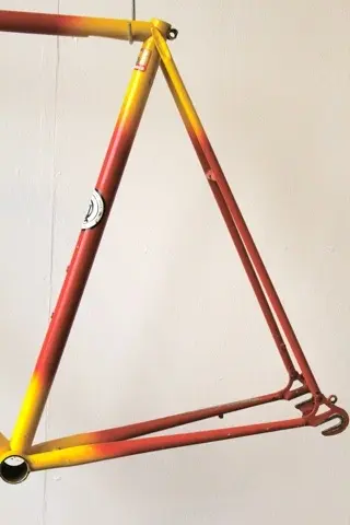

I'm still waiting for more detailed photos, but have these in the mean time.
Thanks again.

Certainly doesn't look like a typical SLX frame at all as others have said. The other pictures might give some more clues when they arrive.

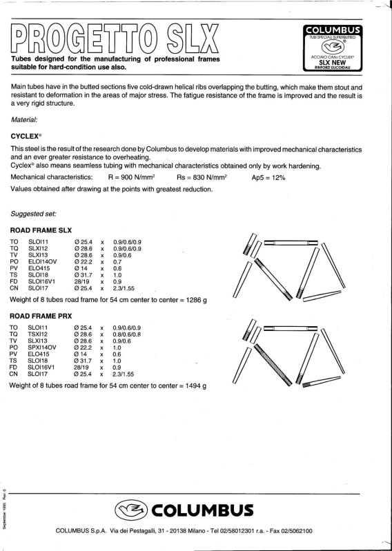

Here's the tube specs for 1995 New SLX...gives an ides of where the rifling (Rinforzi Elicoidali) is:
-You should be able to see the rifling inside the bottom end of the steerer.
-Might just be able to see something down the bottom of the seat tube (with a torch), but access via the BB shall will be minimal on a lugless BB shell.
-Seatpost should be 27.2mm.
-The chainstay taper looks really short for Columbus, and the seatstays don't look 14-10.5mm tapered.
-The stays and fork blades look more Reynolds to me. IIRC Columbus didn't do the swaged domed ends.
Their tubes are supplied plain cut or squarely flattened (on some of the higher end Nivarom tubing), so end up more like this:
rather than
-Internal cabling is smart, but often it amounted to little more than two big holes in the top tube. The better setup is really two long internal cable stops joined by a brass tube, all brazed inside without touching the sides...not easy, and pretty expensive, to do.
-It's got forged dropouts, which is good, but the plain drilled tube brake bridge also doesn't look high end.
Again, I think it's probably a factory tubing mix, with some SLX in there to get the sticker. Nothing wrong with that, but probably not quite as good as it appears...
