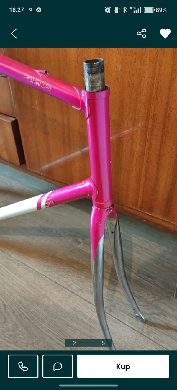

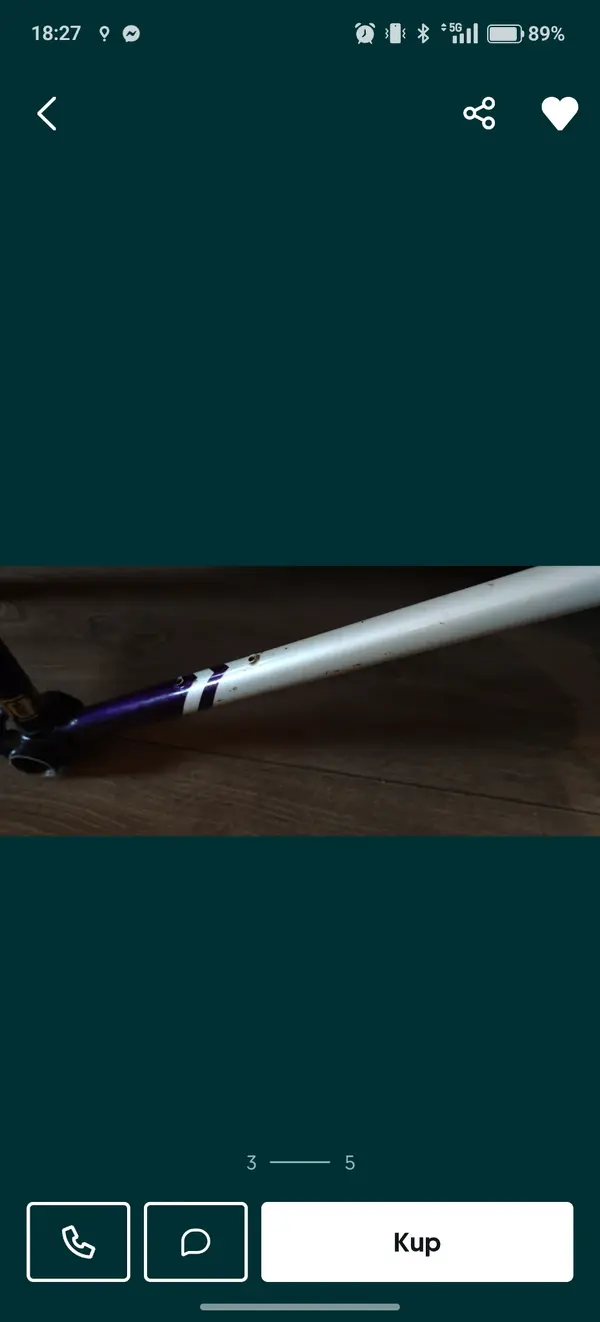

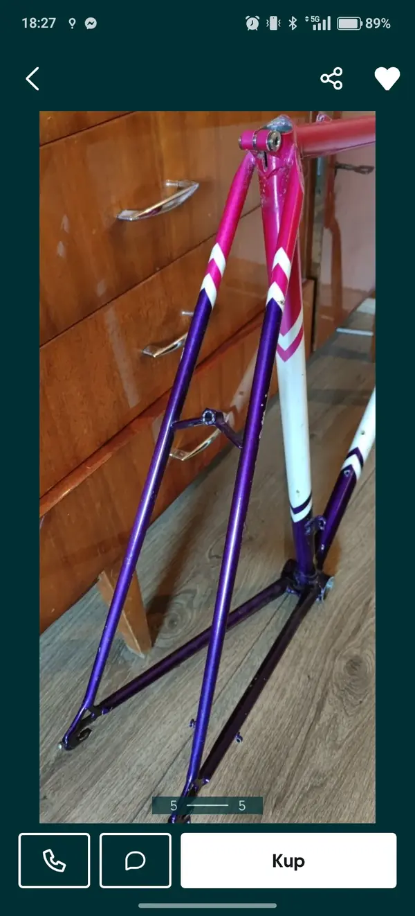

Hello, i hope that you are enjoying your easter holidays šŸ˜‰
I've came across this frameset, it looks beautiful and i have spare parts to build a nice bike on it but i would like to know what it can be before i spend my money on this masterpiece.
Columbus cromor
ITA standard
Giro d'Italia sticker
Everything tells me that it can be one of italian manufacturers.

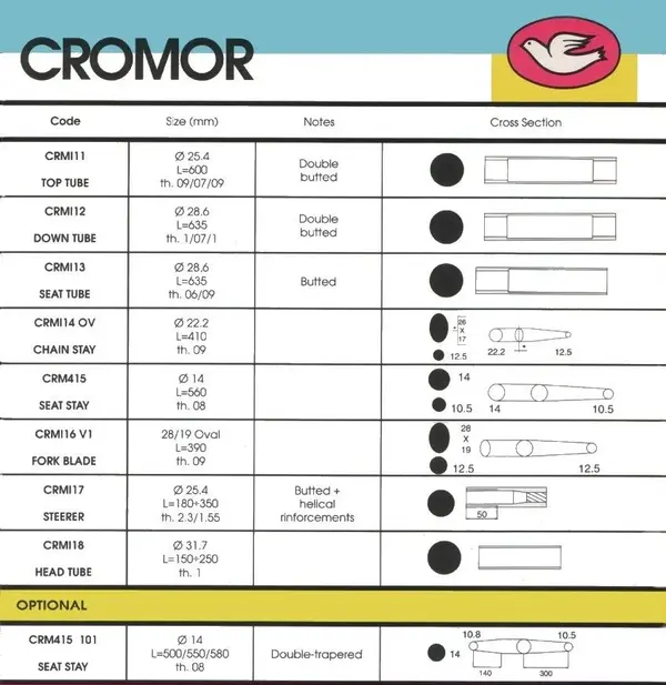

CROMOR: Built of cold-drawn, chrome-moly butted tubing, this set is for the more demanding riders who favour versatile, high-performance light frames, but can also be used for larger frames. Cr Mo Steel - Weight: 2190 g (Note: Columbus Matrix was the first name for Colombus Cromor; Matrix became Cromo when Trek asserted their right to the Matrix name.)
I was thinking about f.moser or eddy merckx (the second won't be ITA support) but i can't find any model that would match this colourway
Merckx were ITA standard, a legacy of Eddy learning from De Rosa.
Having said that I would agree with @Battersby , it looks very Moser to me.
Whatever it is, if it is the right size and the price is right (and if ā€œunidentifiedā€ it should be cheap), it will build up into a very nice bike.

Unfortunately CROMOR's perception has probably kept many folks from getting a bike made of it, including myself passing on a very nice Olmo for next to nothing because (with my nose up in the air!) it was not good enough (i.e. not SL, etc.). In fact CROMOR is a very high quality tube set that is still pretty darn lightweight. Its lack of "quality" is more based on its hierachy of Columbus tubesets based on weight more than anything else. Yes it is a seamed tubing, but of such high technical quality that its attributes are not seriously affected. Thicker walled so heavier, but not lacking quality since I doubt experienced builders would not want to use something hard to work with that does not produce a frame that meets their standards and is suitable its given purpose and price point. After learning about CROMOR (aka MATRIX before name changed c.'87) I no longer turn my nose up to CROMOR (or even AELLE) and now ride one of my favorite frames made with CROMOR tubing; a custom fluted ("Gilco" style) frame made by Rossin. I have seen CROMOR used for TT lo-pro frames for increased stiffness.
