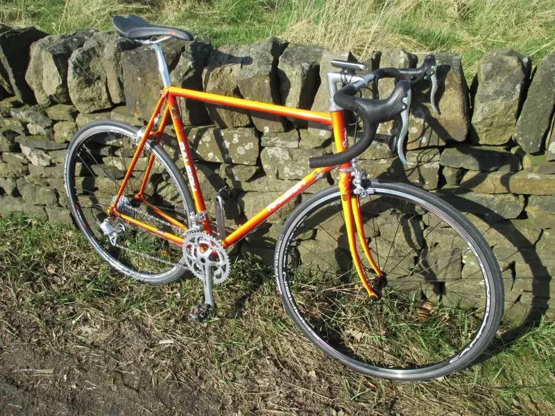

I've been running my 80's frameset with 10 speed all summer.
Any excuse to show a photo :lol:
