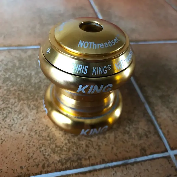

Chris King headset in gold
tractordrafter
Old School Hero
Excellent condition,
Smooth and complete
£50 posted

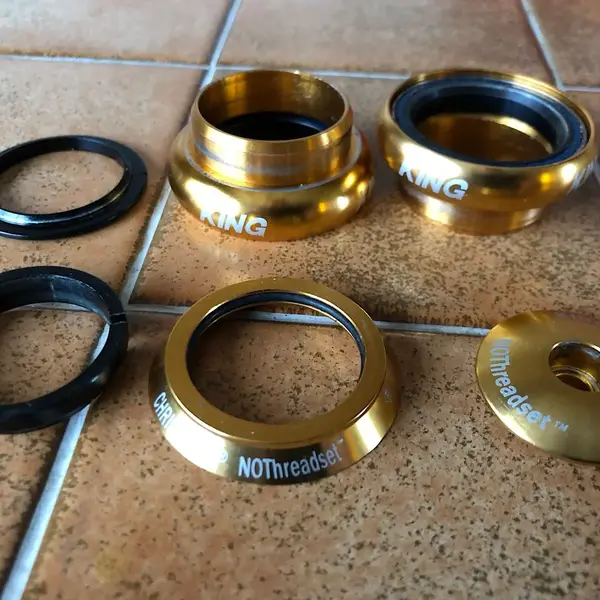

Sorry to be the one to tell you, but that’s not a genuine King headset.
There are a few differences.
The King logos on the cups are a slightly different font and should be repeated more often and closer together.
The compression ring is not separate from the bearing cover on a genuine one.
The text on the top cap and bearing cover is not quite the same.
The crown race should be stainless steel.
The top cap is a slightly different shape.
It’s probably worth that. I hope you didn’t pay too much for it yourself though.
