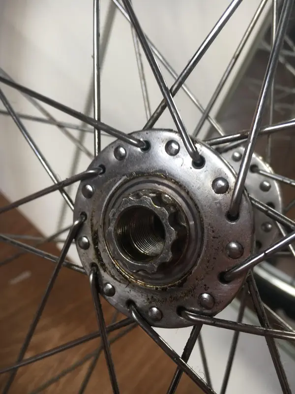

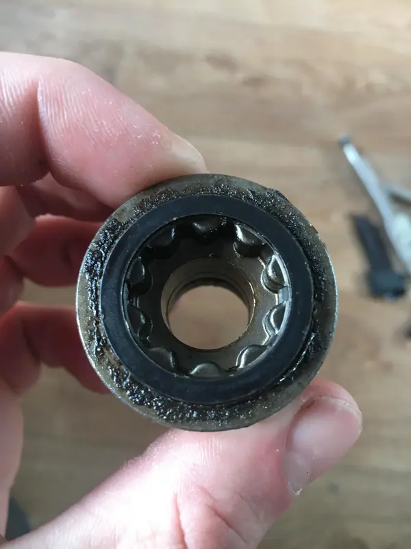

I have a 93 kona hahanna which i am converting to 10 speed (which i'm aware might be sacrilege) and it seems to be the exception to every rule. To do this I have to replace the 7spd HG shimano freehub body with an 8/9/10spd freehub body. I bought a freehub body that was explicitly 10spd and the interface splines between the hub and freehub body do not fit which was my first mistake. However looking at 8/9speed freehub bodies it seems that the interface splines of these freehub bodies match my hub, see pics for reference. I have seen dissenting opinions about the interchangeability of hubs and freehub bodies and was wondering if anyone can help me in discerning whether i can purchase a replacement 8/9spd freehub body and fit it to my (originally) 7 speed hub.
TLDR:
the hub that comes with the 93 hahanna is the shimano FH-HG20. Can I replace the freehub body with a Shimano Deore M510-525 Freehub Body for instance to increase the cassette range?

Check your rear dropout spacing - could be 130 rather than 135. If 130 you could still put on a Shimano road hub but you would need to use a 105 rear mech to get the right cable pull. 8,9,10 freehub should go straight onto your existing hub re the inner splines. Weird if it doesn’t. Whenever I have done this (usually a 7 to 9 conversion) the freehubs just go straight on.

You can swap freehub bodies (as LGF says) with the following health warning: it is easier to use an entire hub as a donor as Shimano repeatedly changed dustcover and cone dimensions over the years.
Agree with this. Take the new hub, rip off the axle, cones, and freebody and then transplant the whole lot to your old wheel / hub. Then re-dish. Then worry about the new cassette, chain and possibly new chain ring.
