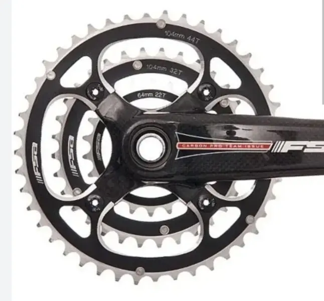

Hi all,
What would be a suitable replacement for my large chainring please. It’s a 3 x 9 setup. Sorry, I have no idea. I also apologise for the ugly toes 😁 IMG_0794.webp
You can probably get a replacement from the current brand - FSA.
But there are a number of brands and places to buy from.
It's a 44 tooth chainring, 104 BCD (bolt circle diameter).
Should be widely available.
Try Spa Cycles or SJS cycles (both online shops), or ebay, or of course, your local bike shop.
I notice some places list their chainrings as 9, 10 or 12 speed. Does it not make a difference?
I thought a few of the teeth looked a bit sus. That’s just going off what I’ve seen on YouTube. Do you think see looks ok? I just don’t want to prematurely wear the chain etc
I may be wrong but I think some of the teeth are shorter to aid shifting up to/down from the big chainring. If that's what you were thinking was wrong? Usually very worn teeth are sharp/spiky or hooked, those look still quite rounded.
Have you been having any problems when using the chainring?
The info you need is the "104mm BCD", and it's a 4 bolt chainring.
