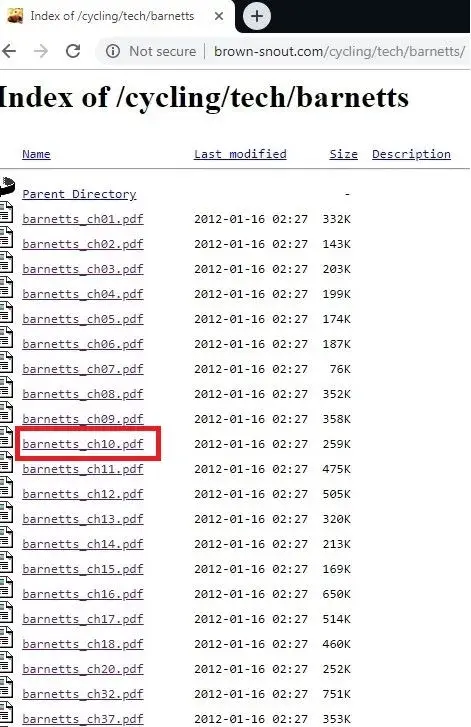

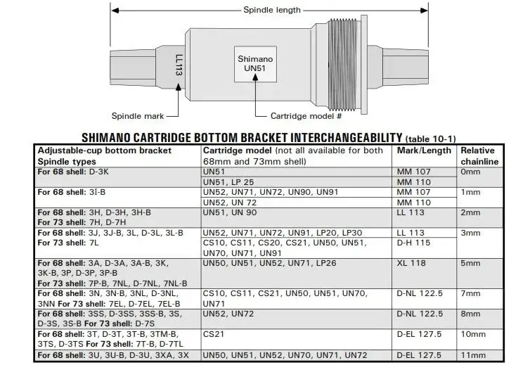

For an additional insight re cartridge bb you may consult chapter 10, interesting read at least...
