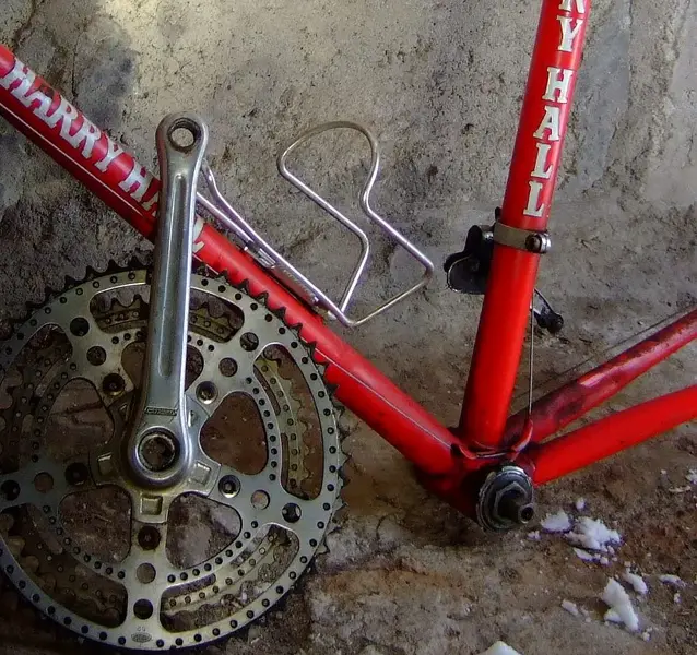

All was new on my 1970's Harry Hall. I am keen to prevent my stonglight front chainwheel from wearing out,I suspect mine is no longer available ,I think I bought the last shop soiled remnant from SJS.I

Posted, a pic of pre restoration showing chainwheel
