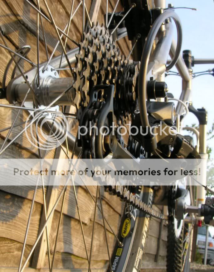

I find that this method works well by accommodating the chain length required for Long Cage/ Short Cage Mech – Triple/Double Chain Ring.
Small Chain Ring to smallest Sprocket, with the Rear Mech cage resting, or nearly resting on the Chain.
The same set-up in a gear that would be actually used when riding - large Chain Ring to middle Sprocket, which I find to be about right.
