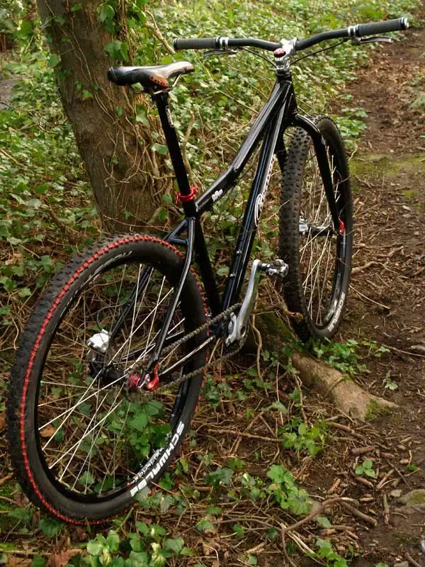

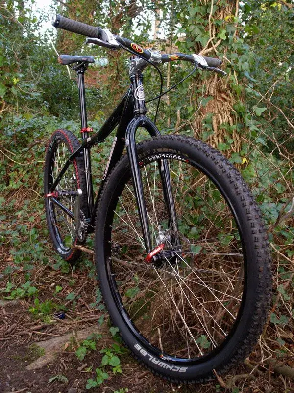

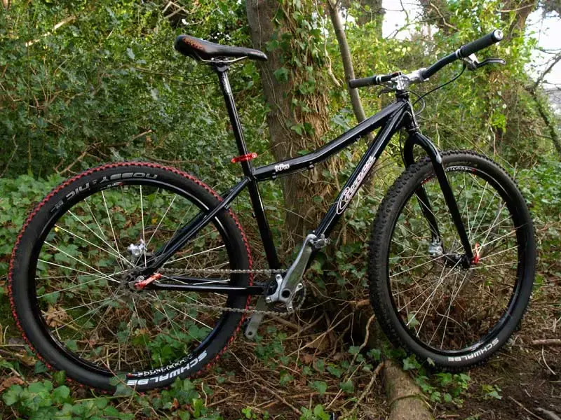

No, not really but for some strange reason the embedded images gave up working and I couldn't be bothered to figure out why.
Here are a couple anyway - just an on-the-cheap build (obviously, I hear you say) with just stuff that works for me but I gave it a bit of a razz around yesterday and all seems good.
For a lot of what I do it's nice to have a smallish bike (16.5" C -T, 22" ETT) - the only problem is a little bit of toe overlap but nothing I can't live with.
Weight is right on 9.25 kgs.
Gearing is 32:20, tyres are tubeless, everything else is just what you see really. If I'm scratching around in the woods I'd be running a saddle height maybe 30mm lower and if it's jumpy stuff about 80mm lower.
Let the abuse begin...... :roll:
PS I'm sorry about the mismatched tyres but I already had a pair of the ones with the red stripes so I used one on here.

Componentry is pretty much as follows -
Forks - Salsa Cromoto Grande
Wheels - Hope Pro 2 hubs (rear SS/trials), Sun Ringle EQ 27 rims, DT 2.0/1.8mm DB spokes.
Brakes - Magura Marta SL with 160mm rotors
Cranks - Shimano M760 (I think)...with Shimano BB.
Chainring - Salsa 32T
Sprocket - Chris King 20T
Chain - KMC Z610-HX.
Headset - Cane Creek S8
Stem - Hope 90mm
Bars - Easton Monkeylite 660mm
Seatpost - FSA FR280
Saddle - SDG Ti Fly
Seat clamp - Superstar.
Tyres - Nobby Nic (tubeless) 2.35" F and 2.25" R.
I think that's about it.....
