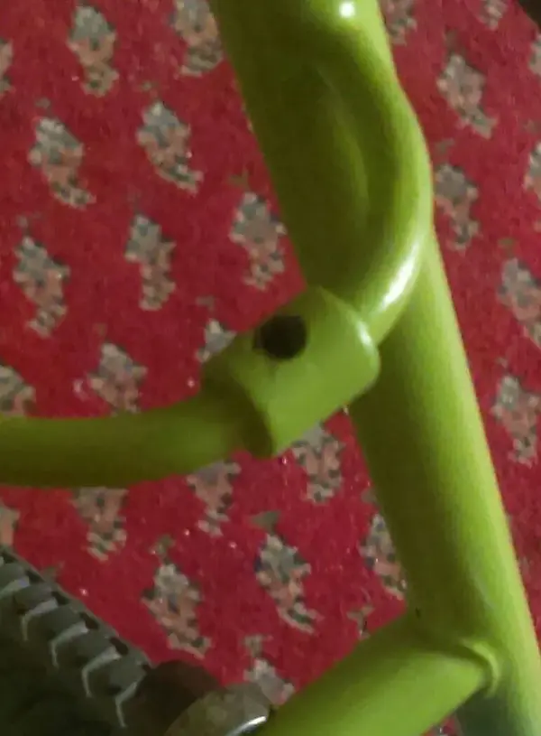

Help me please Obiwan, but I am missing the small screw that takes the rear brake cable at the back of my 76 Carlton Corsa. Does anyone have one to sell or know of a source for Carlton spares? Thank you

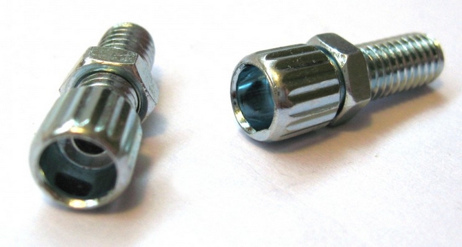

Is it not just one of these?
Brake barrel adjusters can be a bit wider than the tiny hole in the Carlton rear brake bridge.. Above is M6 if memory serves. Iirc from my youth an adjuster from a downtube shifter will fit or from a front / rear mech.
http://www.ebay.co.uk/itm/Vintage-Simpl ... SwEzxYcl26
If you have adjusters on the brake levers then just use a ferrule at the back
Shaun
Yes normal barrel adjustors and similar parts from other brakes are too wide for the Corsa brake thing. I'll try the parts you mean Shaun thanks
