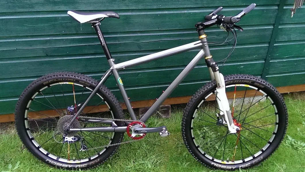

cut it (i did exactly that for my SID world cups)
or you could get one of these:http://ridefullgas.com/brands/SPN-Precision-Components.html?page=2&sort=featured
