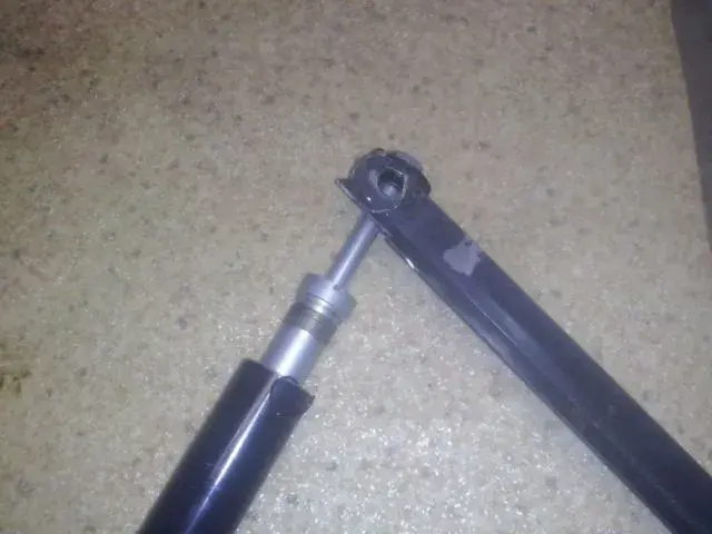

After much faffing, damper is out.
Diy tool made from old steerer....., slot made and hammered over a socket to slightly reduce thr diameter.
Weld onto piece a steel angle then cut slots with hacksaw and grinder, fettling with a small hand file.
And it worked, even better forks have spring not elastomer. :mrgreen:
Took a few hours to make, mostly measuring up, Couldnt find the took for sale anywhere and woukdnt have wanted to pay more than £6.95 anyway.
Next step to peek inside the damper.....

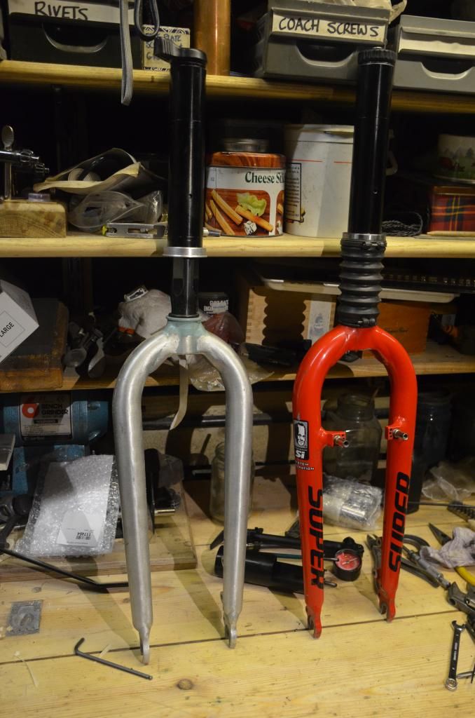

Anyway to tell which model is mine?
I ordered the boot in the second link but it is too small :(
There doesnt appeat to be any fluid leaking from the damper but the rod moves about 10 mm before squelching, im guessing it just needs a top up.
Is this not an exploded diagram of your damper. DL70 and 80 are just the different amounts of travel which you can measure now with the damper out. The measurement if the actual fork travel rather than the damper travel. I am almost certain that is what you have taken out.
The squishyness sounds like lack of oil with some air as well. I would drain and put fresh oil in and turn upside down and bleed the air out of it. While you have it out I would recommend replacing the bottom seals
http://www.headshok.it/italiano/s0/fatty_super.html
I have used the slim boot on a similar fork and it does fit. Just pulled the receipt out to check I ordered the same one and it was. The one on the right in the picture below is that boot. Its a very tight fit but with a bit of grease to lubricate and a hard pull it will go on.
