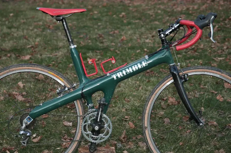

Here is a picture of a 1994 26er Trimble with 700C wheels. Fitted a Pauls rear brake. if this helps? 20111217img_4422_f57185ea234223cdf4ebddd9abc4f7ab36d5aa40.jpg
