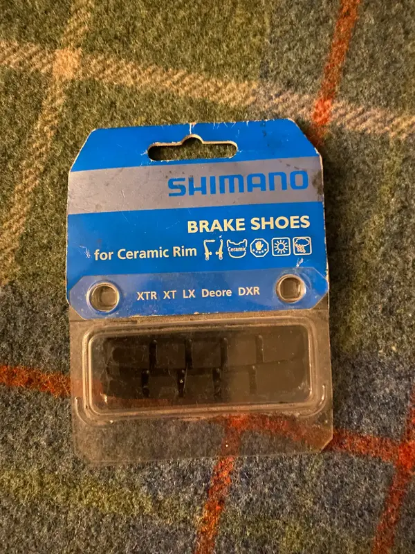

I’m building up my Slingshot at last and will be using some Crossmax’s until I get some more suitable wheels built.
Brakes are modified Boulder (like Onza) so need unthreaded posts. I thought I had a few spare ceramic pads but it turns out they’re all the threaded type. I’ve a load of standard ones though, so other than rapid wear on the ceramic are there any other issues to using them? Are they likely to mess up the brake surface?
I don't think so. I've run standard on ceramics many times (mavics too). No issues, less noise when braking is a bonus.
I tried a set of the red ritchey pads on ceramic rims once. The braking modulation was superb, but the pads wore out in 1 ride.
My experience has been mixed. Decent soft compound brake pads wore out in no time, but cheapies (both standard and ceramic), and rock hard NOS pads ruined the ceramic coating at first contact with the rim…
Dedicated ceramic pads are totally reasonable in my opinion. You can still buy KoolStop Eagle (green for ceramic rims) etc. for about £15 a pair. They last forever, dont damage the coating, and offer superior performance, which for me is one of the reasons for using ceramic rims (and dedicated pads) in first place.
Thanks @sunympholepsy. In that case I'll have do the right thing and buy the Kool Stops. SJS Cycles are the only place I can find with them @ about 20 quid and they only have a couple of sets left
