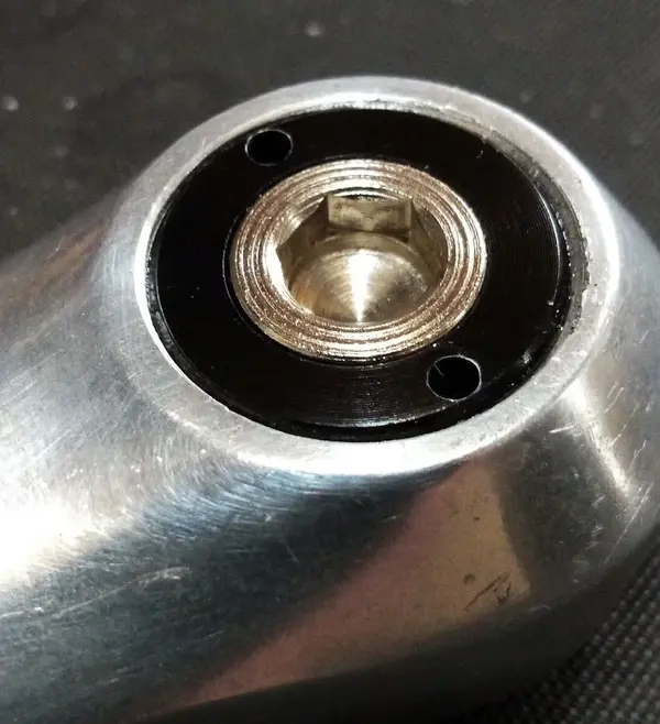

OK. VAR thread repair and auto-extracting bolt fitted.
Old damaged thread bored out on the mill to 22.5mm (for M24 x 1.5 tap).
New thread tapped:
Greased captive bolt inserted with new retaining ring lightly threadlocked.
All clean and ready to go:
All the best,
