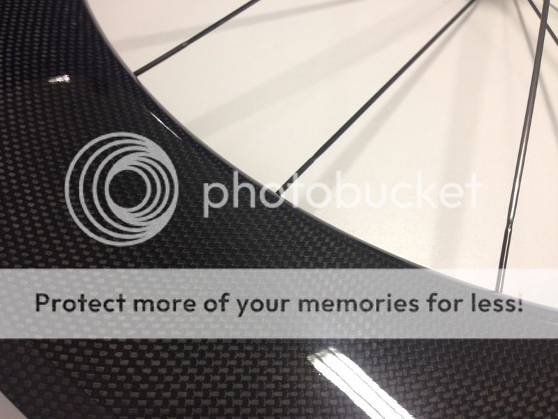

Nextie seem to have a good reputation, especially in their development of fat bike rims.
I have no concerns to date with my dealings with them of the asthetics of the product, my wheel builder had no concerns either.
Note that I have some campy boras to use a a comparison and in some respects (I am surprised I am saying this !), the Nexties compare favourably - particularly around 'hidden' areas like the drillings under the rim tape / tyre etc.
Yes, I still need to ride them though ... :lol:
