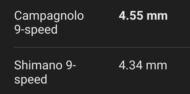

Might be easier to respace your campy9 cassette to shimano9 spacing. Screenshot_20240526-150944_Firefox.jpg

Simplest is to slim the campy spacers down 0.2mm and add a 1.5-2mm spacer behind the cassette.
The chains don't mind the sprocket thickness, it's just the centre to centre needs that little adjustment.

Thanks for the details, I had thought that slimming the spacers would not be possible but if they are 'soft' it would be straightforward I suppose. I have a couple of Shimano derailleurs. Sounds like be the way to go.
Unless you have precise machinery, you'll never slim the spacers down accurately. Even if seems ok at first, it will always be a temperamental fix.

I see that the spacers are resin and so would not put up much resistance to fettling, I have an engineering background working to close tolerances so am looking to try this route first. I will report back on results, perhaps in a different thread.
