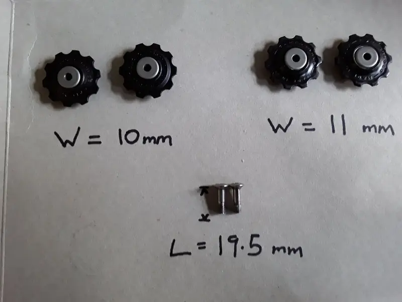

Short bit: I need Campag or compatible bolts for my derraileur pulleys of @ 18mm or less.
Long bit: On fitting my 8 speed Record rear mech, the pulley bolts are sitting 1mm proud of the inner plate and fouling the spokes, even with the limiter screw set correct. As soon as I hit 1st it is rattling the spokes.
I bought replacement 8 speed pulleys which oddly enough are 1mm thinner than the old ones, so I can fit those and gain a little distance.
The problem of the bolts remains though, as they come right through and are well proud of the inner plate. I could file them, but you know where that end up.
Any suggestions or suitable bolts would be a big help.
I might do. Dont want to damage the cage like. I've looked up campag bolts and the only size I can find is 16mm for this era derraileur.

I'm going to put an M5 nut on them to protect the thread and give them a file in the vice. Should do it. Nothing to loose.

Great info Jim, thanks. I went ahead and filed the bolts to make them flush with the inner cage, they are now 17mm. The replacement wheels are not compatible with this mech, even though they are 8 speed. Beleive it or not, the raised 'Campagnolo' lettering etc on them was fouling the cage when fitted!
So kept originals on. Even though the bolts are out the way now, the inner cage still catches the spokes upon shift.
The wheels are brand new, built superbly by Paul Hewitson.
I'll have a closer look at the frame, as I did stretch it out 15mm to accommodate 8 speed from 6.
The record mech was an Ebay buy and is looking suspiciously skeewif. I have a spare xtr 8 speed, so might fit that for a comparison.
The build is almost complete. Very frustrating at this point.
