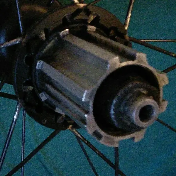

L LordJohn Retro Newbie Nov 27, 2015 #1 What campagnolo cassette do I need for a campy proton etrto wheel ?
L LordJohn Retro Newbie Nov 27, 2015 #2 Re: Hub Attachments IMG_20151127_143129.webp 203.5 KB · Views: 257 IMG_20151127_143212.webp 155.7 KB · Views: 257
H hamster Retro Wizard Feedback View Nov 30, 2015 #3 It looks like an alloy hub body, so will take 9, 10 or 11 speed cassettes. 8 speed will fit but not go to the bottom of the splines and if used will chew up the freehub body. If a steel body with shallow splines, only 8 speed will fit.
