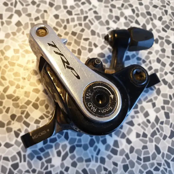

Sorry for the delay, once again my memory is playing tricks on me. Can't find the SLC Spyres but i have got this one in good order. I like Spyres. Their weakness is that they can get a bit gritty, but in my experience they are really easy to strip down and have feeling like new again - takes about 20 minutes.
This one is £23 posted if any good.

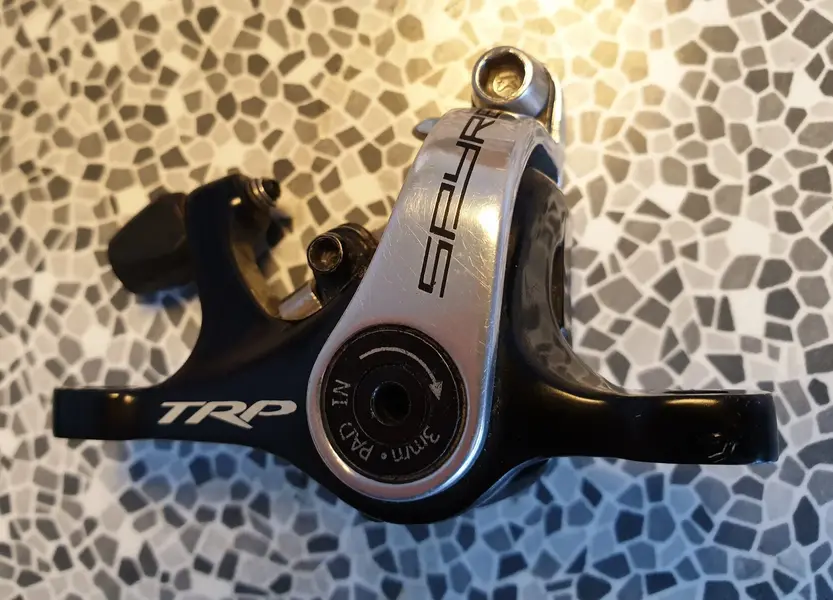

Hi Rich, I might go for that caliper, but I am still unsure on the fork... There are QR/post mount and TA/flat mount options. the TA is more expensive, but I am leaning towards it as I can see the advantages for heavy touring. Any idea if and how this caliper would fit to a fat mount fork? Pic of the fork (surly disc trucker TA), with a spyre (flat mount version):
The caliper i'm selling can be fitted to a "normal" flat mount fork. The fork in your image though is unusual in that it is using a rear flat mount adapter, so my caliper would not fit that fork.

Yes I thought the surly fork was a rear FM style, rather than a front FM style. Looks like the FM caliper would bolt straight to the fork for a 140mm disc, and the adaptor in the pic is for 160mm. I am very undecided on the dropout thing - I feel that QR should be fine and give no problems at all, but TA does have advantages... the surly fork in QR version is ISO mount, I think, so easy to adapt to any caliper.
