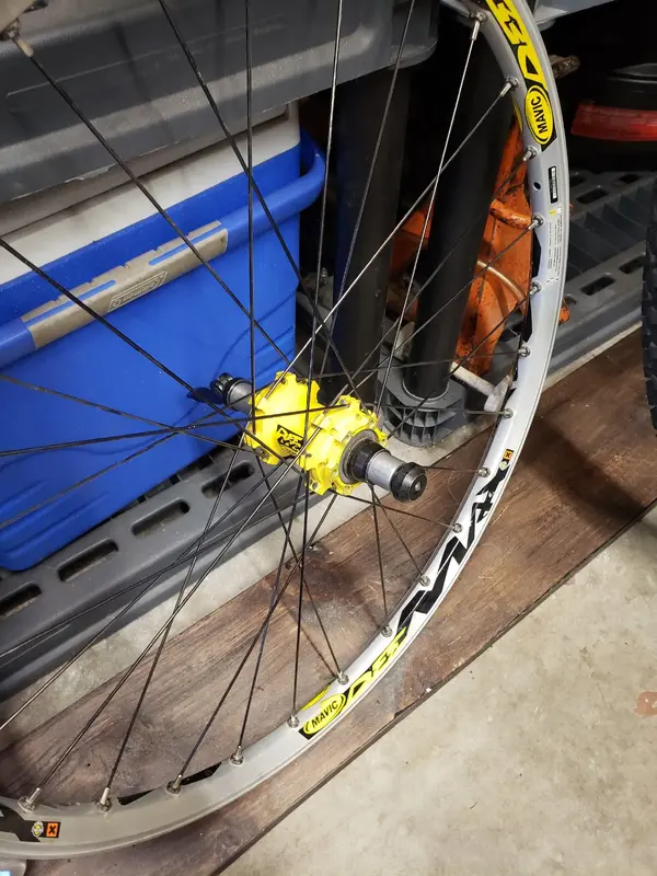

*Front wheel wasn't a 20mm axle. Already lined up a used Mavic DeeMax

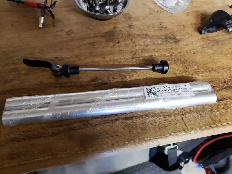

I've got most replacement parts coming soon, the QR20 axle will be the biggest project as I have to fab up a spacer to fit in the 20mm axle. Although I've got some 20mm OD 15mm ID aluminum tubing coming that I think should do the trick.

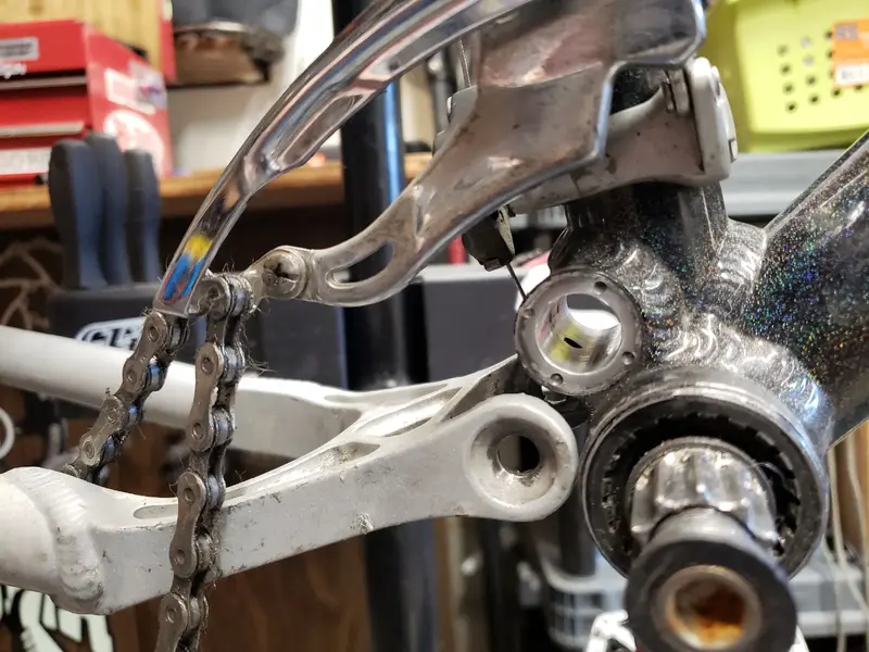

Noticed some play in the bushings behind the BB. Struggled a bit to remove one of the bolts. There is a threaded bolt on the backside of that bushing. I used a water bottle cage bolt to keep the axle/insert from spinning. Apparently there is a hole drilled in it, proper way is to spin the stuck bolt/insert and place a 3mm allen key in the hole to keep it all from spinning.
I measured the bushings. Waiting to hear back from RM if they have bushings, otherwise I'll be getting some from Igus. Measured 16mm OD, 14mm ID, 17mm width. Igus flanged DU bushing.

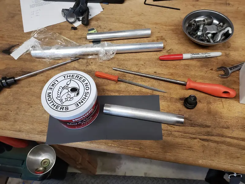

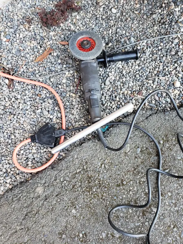

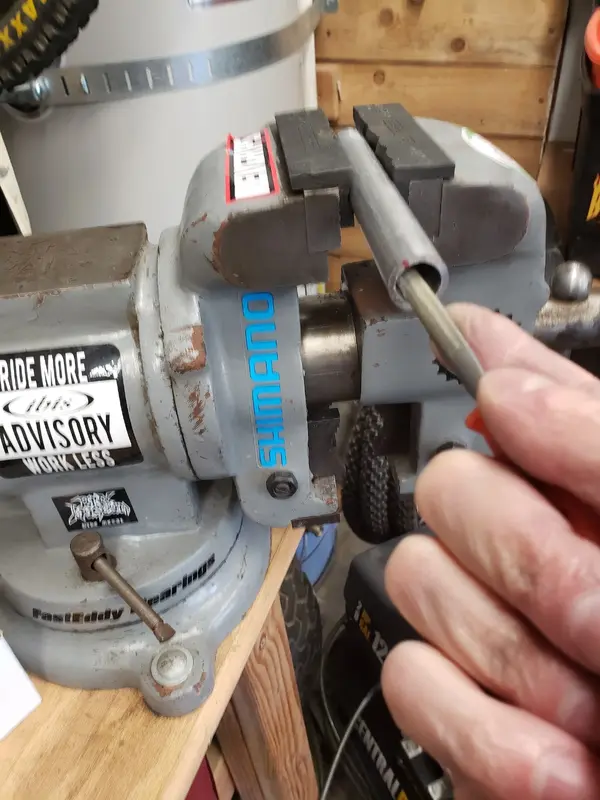

Had a fun time making the missing piece for my QR20 axle. The metal tubing I bought was close but not 100%. Spent about 2 hours resizing the tubing to work.
Of course a few hours after finishing Marzocchi Mark let me know he has the piece I need....
