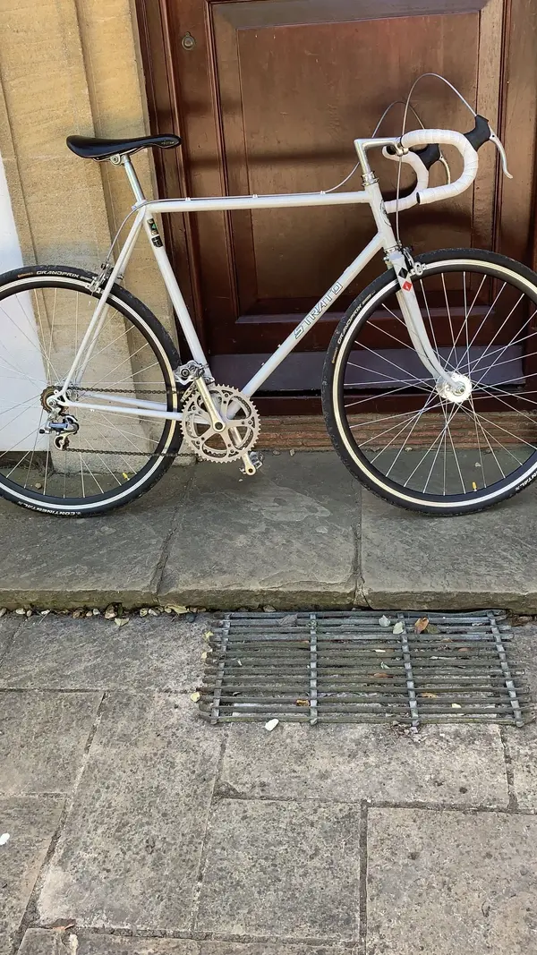

As suggested I sent the 10/11 speed wheels back and got nice set of “mad speed 7” single speed wheels from eBay. They arrived with some trashy stickers on them, but luckily they peeled off easily.
New hoods, bar tape, bit of a polish up and I was done.
Only slight challenges were the chainset and chain. I started off using the original Solida double, on the small 42 ring. But I had to use the 10 speed chain with this, which didn’t work with the single speed rear cog.
So then I cobbled together a mis matched campag chainset, which luckily seems to work okay with the original stronglight bottom bracket. I then reverted to the 1/8 ss chain and all was well with the world!

Some some pictures, with the Solida and a rear mech to take up the chain slack as a temp measure
