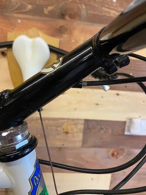

Looking for a little advice on a Breezer stem.....
It has a lovely bit of cable routing - but is it likely to have an internal tube to guide a new brake cable through - or do I leave it well alone as I'll never get a new cable through there?
It looks like it does - I'd just like the benefit of some Breezer expertise, please :)
Thanks in advance 👍
No expertise but I'd give it a go because if it was a hassle to route a new cable through I'd bin it as obsolete tech
Had same issue with old Kona stem. I put a piece cable liner through first, easy to thread the cable through that then, you can then pull the sleeve out if you want, I left it in mine, same length as the internal hole so you cant see it anyway but makes the cable run smoother in my opinion.

They're easy to put a cable through, slung one on my hinde and used a bit of sleeve as said above.
